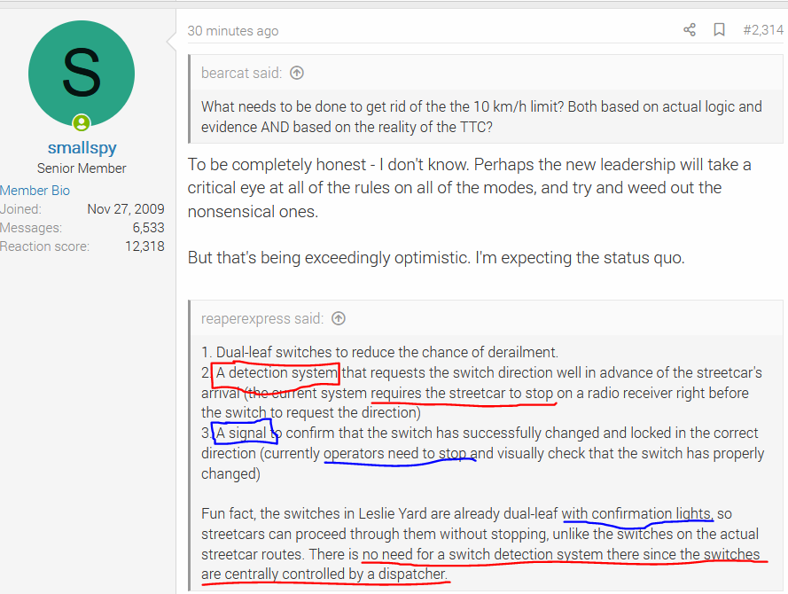

What needs to be done to get rid of the the 10 km/h limit? Both based on actual logic and evidence AND based on the reality of the TTC?
1. Dual-leaf switches to reduce the chance of derailment.
2. A detection system that requests the switch direction well in advance of the streetcar's arrival (the current system requires the streetcar to stop on a radio receiver right before the switch to request the direction)
3. A signal to confirm that the switch has successfully changed and locked in the correct direction (currently operators need to stop and visually check that the switch has properly changed)
Fun fact, the switches in Leslie Yard are already dual-leaf with confirmation lights, so streetcars can proceed through them without stopping, unlike the switches on the actual streetcar routes. There is no need for a switch detection system there since the switches are centrally controlled by a dispatcher.
To be completely honest - I don't know. Perhaps the new leadership will take a critical eye at all of the rules on all of the modes, and try and weed out the nonsensical ones.
But that's being exceedingly optimistic. I'm expecting the status quo.
First off, this 10km/h speed limit over specialwork has nothing to do with the switches. It applies over trailing switches or intersections where there are only crossings, too.
Second off, and once again, the type of switch itself has no bearing on any of the rules currently in place. Single-point switches are just as safe as dual-point switches with the current and past equipment. The issue is with the switch control system, which should have been replaced 20 years ago or more - that's the stop-and-stay rule that has been in place for a long time at all facing switches.
To your point about Leslie, it's not the dual-point switches that allows them to proceed without stopping, it's the fact that they are controlled from the central yard office and thus can't be changed from within the equipment. Thus, there's no way for the current, antiquated N/A system to potentially change the position of a switch without the operator knowing (or paying attention to).
