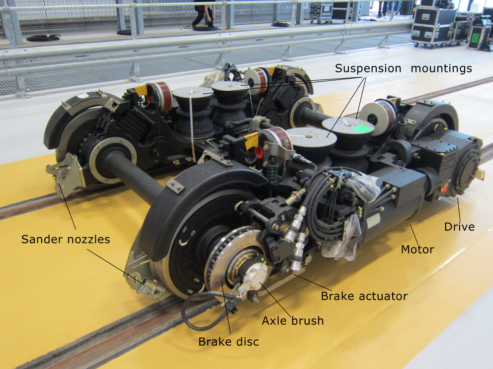

But the point was that the placement of the wheels on a bogie of a tram will affect the bending moments induced on the plate. Since a tram's bogie has 2 axles close together, the force will effectively still be double that of a bus. Vehicle length doesn't really matter when all loading occurs in distinct areas.
193630
193631
In other words, the bus may be applying 9.5 tons*g of force per axle, but because those axles are almost always evenly spaced, the strain (and therefore bending moment) induced on a plate will be pretty much always evenly distributed.
The design of the structure is obviously not one giant plate 10 meters long simply supported by 2 beams at each end, that's pretty much begging for a structural collapse. Therefore, even though the 3 buses and the one streetcar weigh about the same and have about the same length, the difference is in the placement of the axles. Since Streetcar bogies have 2 axles very close to each other, the effective load is much greater than the evenly spaced bus axles.

But the point was that the placement of the wheels on a bogie of a tram will affect the bending moments induced on the plate. Since a tram's bogie has 2 axles close together, the force will effectively still be double that of a bus. Vehicle length doesn't really matter when all loading occurs in distinct areas. ... In other words, the bus may be applying 9.5 tons*g of force per axle, but because those axles are almost always evenly spaced, the strain (and therefore bending moment) induced on a plate will be pretty much always evenly distributed.
