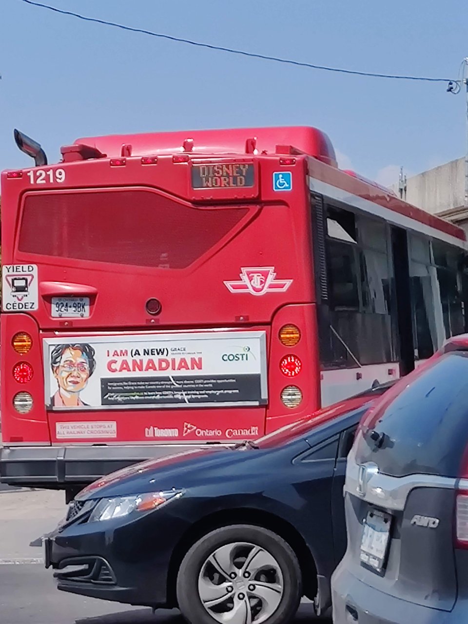

Does anyone know if there is an extra fare required to ride this bus?
