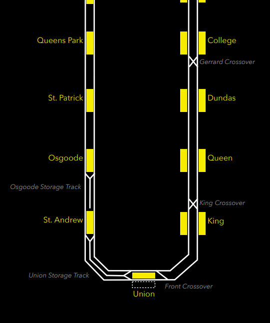

Has there ever been any serious consideration of splitting the Yonge-University Line in half, or splitting service in half during rush hour? It seems like it happens way too often that a problem happens on one side of the line, but it screws up the entire line (and as a result also screws up Bloor-Danforth).
No official consideration - but poster Gweed had this from a few years back.
I thought he also suggested the University side going down to York (and Yonge ending at Union), but I couldn't find it.
Apparently in the early 70s there was a general idea to expand Union with 4 tracks/6 platforms. Not sure if they planned on detaching the two lines, but it could arguably make sense. The Gweed plan would be pretty sweet and solve a lot of problems going forward (waterfront transit issue, seamlessly getting tourists to major destinations like airport, Skydome, Ex grounds, etc). Combine that with a Crosstown-style LRT on Queen or Dundas and we'd have pretty solid coverage.

Or can they turn back trains at Union to at least keep up frequency between Finch and Union?
Absolutely. I checked this all out last night, had an extensive post, with maps and track diagrams for the subway, albeit from 2014. I decided to erase it, as the case my post made wasn't definitive.
The downside to turning back trains at Union from both both legs (which can be done by treating each as opposing stubs w/ ability to cross transfer at Union for through passengers) is the 'turn around time'. That's a loss of headway of at least two to three minutes for each independent leg vs through-running.
So the *practical answer* for splitting the legs is 'no, except in emergencies to maintain a reduced service interval on either leg'. The cross-overs are there, but the signals might be very slow on top of the crew change needed on the train.
In an emergency, if one leg isn't running, then ostensibly both platforms could be used at Union for the leg that can run which might reduce the lost headway somewhat from just a single stub termination which would be the case if the crippled leg needed to leave a train in one of the platforms, while the other track is used as a stub for the healthy leg.

There are 6 BIG problem to do the plan shown in posting 9355.
Which line will have to be rebuilt to get under each other??
How deep does the Yonge line have to be to get under the current plan tall towers?
How long will these 2 lines be out of service for Union??
How do you deal with the double loads at King St station when Yonge/King can't handle it today??
How do riders get from one line to the other line to get to where they want to go in the first place??
What happens to the current plan for the DRL routing??
