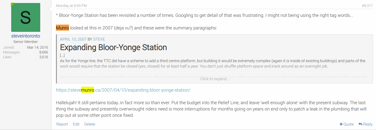

This TTC board meeting document, PDF on pages 44 and 45: https://www.ttc.ca/About_the_TTC/Co...TTC_Capital_Investment_Plan_Supplementary.pdf
And this Steve Munro article: https://stevemunro.ca/2019/01/21/33-billion-and-counting-part-ii/
This one is older and less fact based: https://stevemunro.ca/2007/04/10/expanding-bloor-yonge-station/
