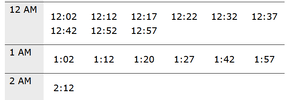

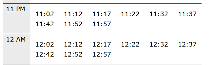

On Tuesday 11:59pm, I saw two westbound 36 buses, back to back, at Finch and Beecroft. How does that even happen? The eastern terminus is Finch station, a few hundred metres away.
TTC route "management", or lack there of is how it normally happens
But looking at the schedules; clearly either one bus was running early, or the other was late.

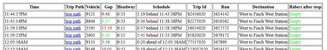

Your information matches the data at Transsee for the Beecroft (aka Greenview) westbound stop - https://www.transsee.ca/stophistory...00:00&endtime=04:00&nextday=1&date=2026-05-26
Essentially the 11:53 pm bus 3603 was about 6 minutes later, and the 11:58 pm bus was 40 seconds late. Looks like the same thing happened for the 11:38 pm and 11:43 pm buses too. Though Wednesday and Thursday looked very good. Looks like they stayed together the entire 15-minute trip to Finch West, by which point the first was only about 90 second late, while the second was 4 minutes early. Looks like at that time of day most of the trips leave a minute or so late and arrive 3 to 5 minutes early!
The reason seems to be that 3603 arrived 5 minutes later on it's previous trip (which it had started at Finch West also 5 minutes late). And on the trip before that it had arrived at Finch West on time. It looks like the operator stopped at Finch West for 7 minutes instead of the scheduled 2 minutes. Perhaps they had to use the toilet?
The root cause I suspect is that the schedule allows 2 minutes layover at one end, and a 1 minute layover at the other end. And if one has to go ...
The good news is the following runs for each bus were pretty much on time.

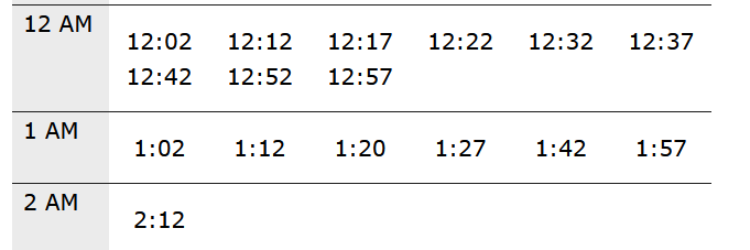

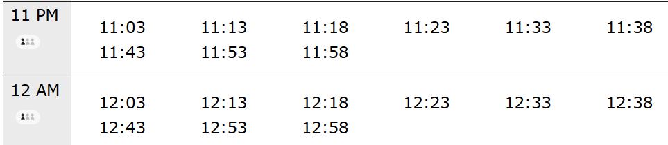

I"m not familiar with that route. Very odd that the gaps are 5 minutes then 10 minutes then 5 minutes ... rather than just every 7.5 minutes.
Also, is this unusual there? Compared to routes I take, service looks excellent!

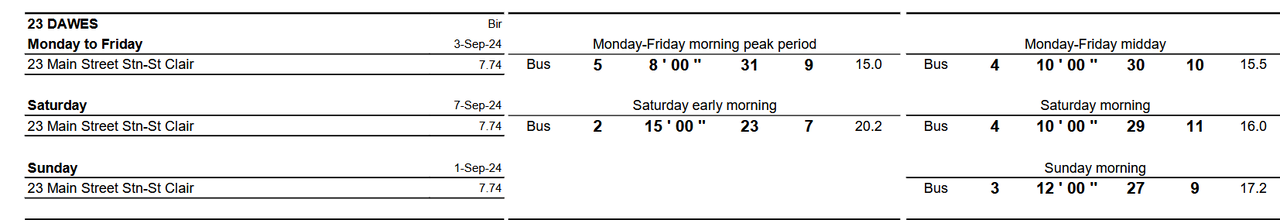

On schedules. Under Rick Leary bus and streetcar schedules were bloated, with terminal or recovery time. This was done to eliminate late departures and short turns,, but has the effect of paying operators to idle vehicles for large amounts of time, for much of the typical day.
Lets take a look a fairly typical Service Summary (thanks to Steve Munro who catalogs all of these)
So you see here that on typical weekday, the service is nominally spending ~25% of its time idle ( 9-10 minutes on a total 40 minute run) in reality, the budgeted drive times themselves have wiggle room in them, which often leads to a bus arriving at Main Station before the previous bus has departed.
Without considering stop removals or TSP or like improvements, the same number of buses, could provide, with a standard 5 minute recovery/terminal time (enough for a quick bathroom break for the operator) and a slightly tighter schedule, every 8 minute service in the AM rush, and the same during mid-day. This would, initially reduce passenger load per bus, the numbers of stops where passengers board/alight, and make the route run faster.
Add some minor tweaks to address the slowest part of the route (exiting Main Stn, Main/Danforth intersection, and Danforth Main to Dawes) and you could drop scheduled run times by 3 minutes or more, cut a couple of stops per direction and make it 4, that's enough to cut headway by another minute.
Most routes have similar schedule bloat and related issues.

With only a few more minutes (3 minutes and 57 seconds) to the following (third) bus? If there's a long gap between buses, then this makes sense. But that third bus was only a couple of traffic light cycles behind this pair!
The data is not quite granular enough, but it appears that the by the time they got to Beecroft, the second (probably empty) bus overtook the first one. Allowing it to pick up any further passengers, while the late one would only have had to stop to let people off. This kind of skip-stopping helps buses get back on schedule.
