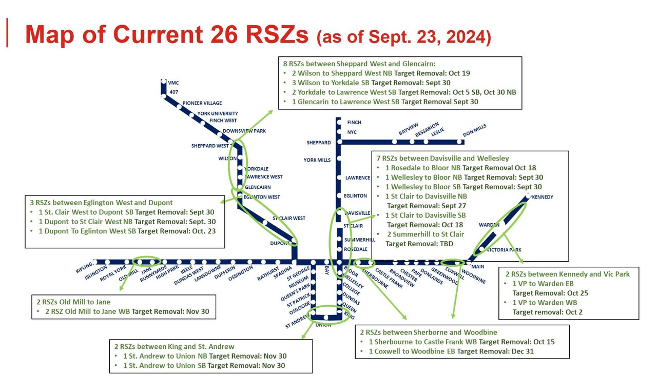

Since January 2023 the accumulated count of RSZs is almost 300. Of these, only 30 were planned, typically for track renewal projects where a slow order is required over an extended period while work is in progress.
The average time to resolve an RSZ was 22.1 days, while the median was 11.6 days. This disparity indicates that although typical times (the median) were under two weeks, there would be many cases well above that length.
When a defect is discovered, the work involved could be localized (e.g. a broken weld) or it could cover an extended track segment (e.g. out of alignment rails on track with deteriorated ballast). The overnight repair window is only 90 minutes long when the time needed for setup and clearing the work site are taken into account. Longer periods are provided by early closings, or by weekend shutdowns of an affected section. After repairs are complete, the repair must be inspected and given a few days to “settle in” before the RSZ is lifted.
In May 2024, inspections revealed 25 new defects, 18 on Line 1 and 7 on Line 2 of which 10 were in open cut track. Additional defects were found through the year bringing the total to 85 of which 65 have been resolved. The work required six weekend and 53 early evening closures.
The TTC has a short-term and long-term plan to deal with this situation. These lists hint at the problems that led to the backlog in the first place, notably the reliability of the fleet of workcars essential to this work and the skills level of staff.
Short Term:
  • Continuing regular maintenance to meet or exceed all North American standards
  • Improving workcar fleet reliability
  • Increasing TTC staff skills and training
  • Exploring options to increase maintenance windows
Long Term:
  • Introducing additional track inspection technology
  • Acquiring our own ultrasonic and geometry survey equipment
  • Enterprise Asset Management investment in data and knowledge
Design is underway for a TTC ultrasonics car so that they are not dependent on rented equipment and can inspect the network more frequently aiming at a “fix before fail” capability. This car will not be available for about two years. The TTC would like to get down to a steady state level of 6-8 RSZs across the system.

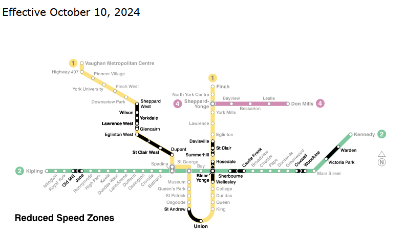

As per usual, they cant stick to any kind of a schedule. Nothing has changed in 2 weeks, so much for those promised timelines:
Oct 2, 2024
I'm just going to leave this here without many words, because this is just pathetic at this point:
Oct 10, 2024
vs. what we were promised:
