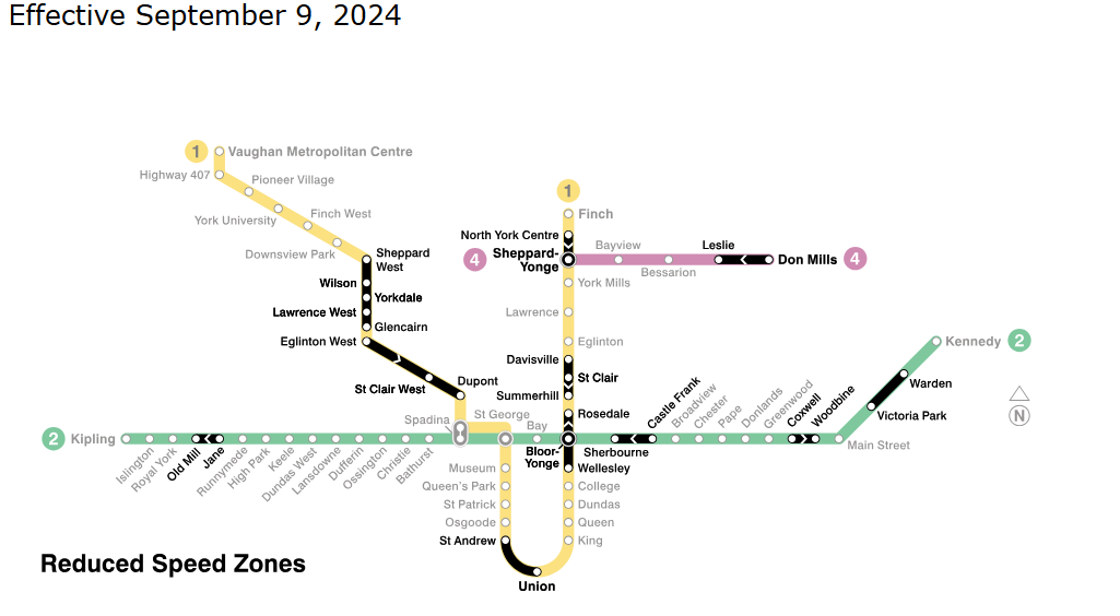

On today's update, we can see the past 2 weeks of various early subway closures between Eglinton and College have had absolutely 0 effect/improvement on the slow order situation.
On a positive update for all those (including myself) who thought Line 4 was finally in the clear, you're wrong. We can see the TTC has gone ahead and added in another one between Leslie and Don Mills.
It seems like we're in month 4 of speed restricted areas along Bloor-Yonge to Rosedale stations, and from Dupont to Sheppard West stations. This organization has no shame in itself whatsoever.

Its not even the older areas like union to eglinton only. How is the sheppard line so bad too? its just over 20 years old. HOW
Lack of maintenance and neglect. That is the TTC in a nutshell.

Rails are a consumable. They have a lifespan, and that lifespan is dictated by a variety of factors such as axle weight, number of axles, equipment performance, curvature, gradient, acceleration/deceleration, ambient conditions, etc.
Depending on where it is located, the lifespan of a length of rail in the subway can be as low as 10 years. And on the mainline, it never gets to 30.

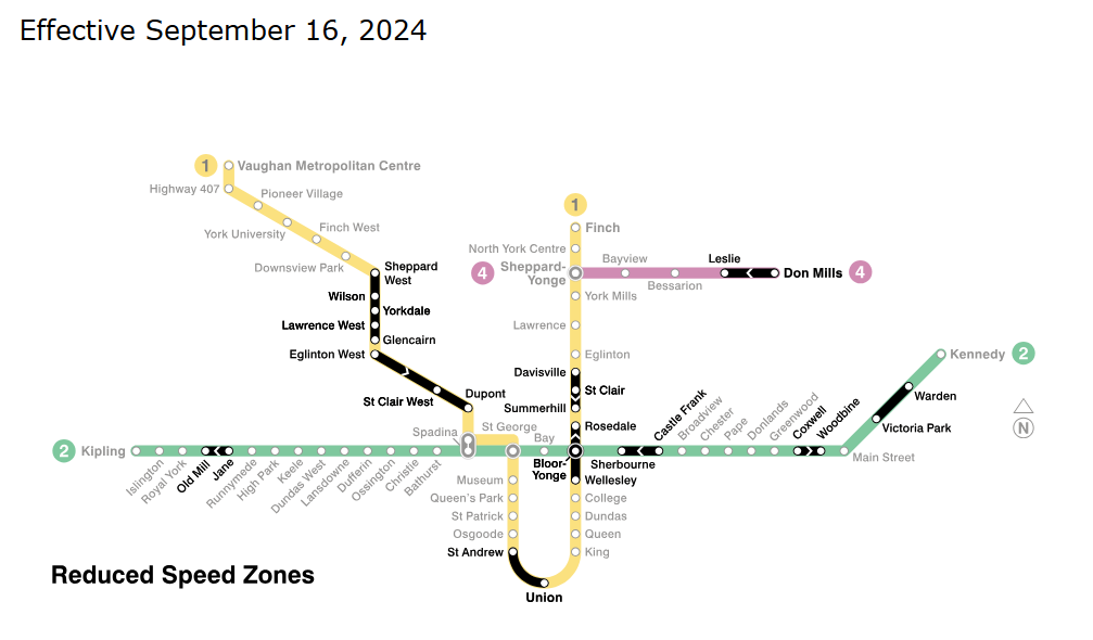

I dont know how many weekend/early night closures it takes to resolve issues on this forsaken subway system, but apparently not enough. As we can see, this past weekend's closure from St.Clair West and Sheppard West stations did nothing to clear up a single speed restricted zone:

I may be wrong as it has been many years but isn't the stretch between Eglinton West and Dupont a long uninterrupted grade? Wasn't there an instance where a train overran signals and/or ran into another train a number of years ago? That slow order zone might be a permanent 'abundance of caution' speed restriction zone.

for what it's worth, when driving up the Allen between Lawrence and Wilson this weekend i noticed a total of two crews working on the line
Yes, that's the Russel Hill collision. The train ran through a red signal. There is an arm on the old wayside signals (its now ATC) that was supposed to trip the train's emergency break if it ran a red, the arm was too low.
No. This is not that.

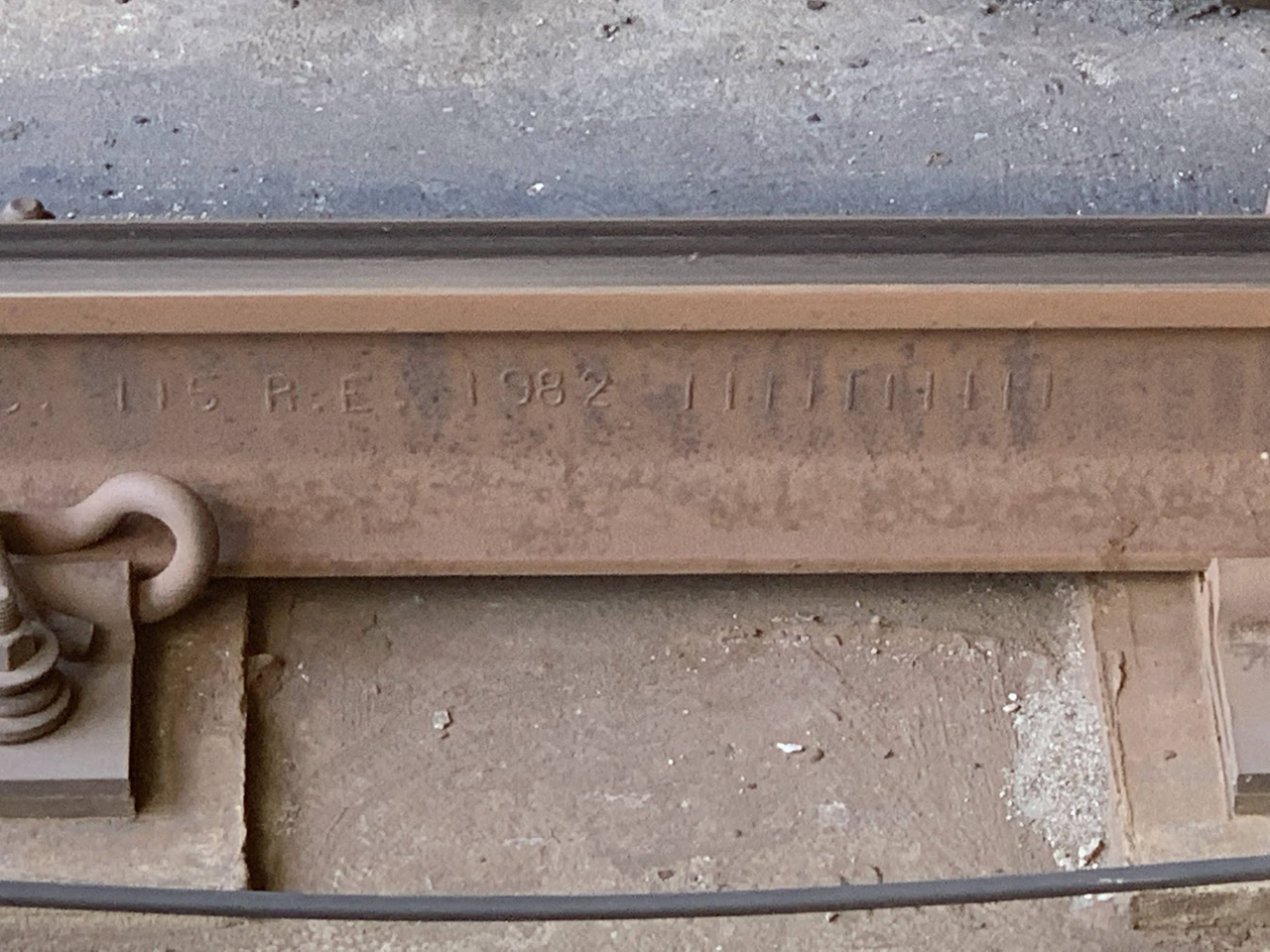

I took a bunch of photos of line 3 a few years ago, I noticed the tracks at least where I was were from 1982!

Maybe the state-of-good-repair can't keep up with the curvature wear both directions from Union. I remember as a regular user trains squeal like hell on those curves. Similar to the underground Bay streetcar loop that had to be constantly water-lubricated.
The sharp curved rails around Union and Museum usually require more frequent maintenance/replacement compared your standard straight rails. So that's something to not be too concerned about.
It's the other sections of track that are going through this severely prolonged stretch "maintenance" that's a concern and abnormal.
A photo of a rail with absolutely no context as to its location is not much help at all.
Especially considering that there were some locations on the "mainline" where the rail very seldom got use, and therefore would have taken far longer than normal to become life expired.
