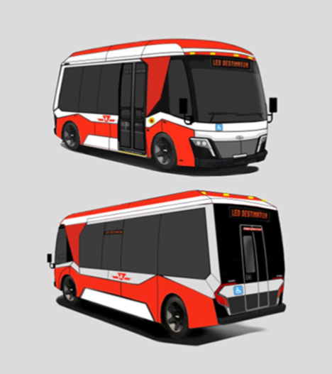

A first look at the future of Wheel-Trans​
As we celebrate Wheel-Trans’ remarkable journey over the past 50 years, here is an exciting peek into the future. Wheel-Trans is committed to eliminating emissions by 2040 by fully transitioning to battery-electric vehicles.
Currently, the TTC is procuring five pilot Wheel-Trans vehicles (pictured on the left). The first few vehicles are expected to arrive and begin testing in 2026.
Through this transition, the TTC’s primary goal remains to provide fully accessible vehicles that meet customer needs. Therefore, the Advisory Committee on Accessible Transit (ACAT) will be a key evaluator of the new battery-electric buses.

Good looking bus.
I wonder if they can use this for the high Park shuttle. I know their looking for an EV buses as well.
Looks like its big enough for community bus service as well.

Brampton transit has been doing a demo or dry run with a vehicle like this. I see it driving around different places.
