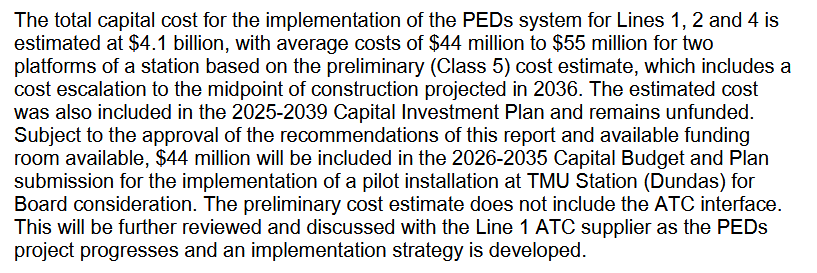

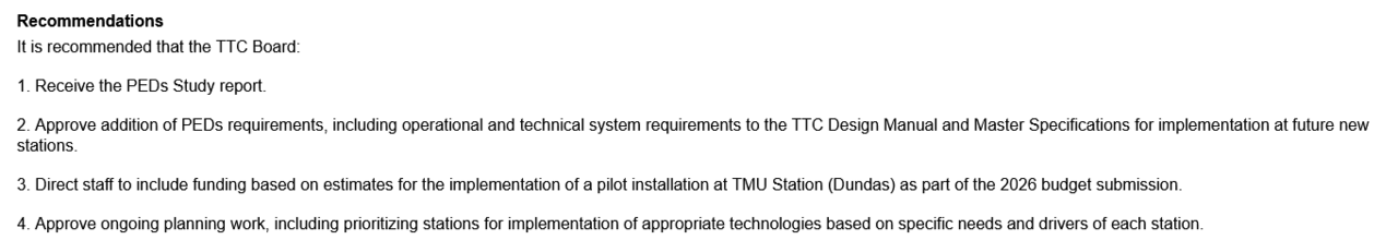

A Report to next week's TTC meeting updates the Commission on the Business Case and Feasibility studies for Platform Edge Doors.
Spoiler.....we're going forward.
Report: (high level link as there are attachments)
Before I go further, I must alert @Reecemartin
Now, from the above:
You'll see below a reference to Bloor-Yonge being unfunded.....I've explained my read on that....... but of note, if this is adopted, B-Y will not be the first station, they will pilot this at Dundas/TMU
Next bit....I'm going to say right now, even understanding the escalator they are using..........I find the estimates unacceptably high.
I have read the full base report. I have not yet read and mulled over the Feasibility Study and Business Case. I will do so later and report back.

My only reservation is the choice of test station....call me risk averse, but I would move the initial test to a less heavily used station - Rosedale maybe?
Having any teething troubles at TMU will be very painful, and therefore bad optically..
Baby steps at first, please !
