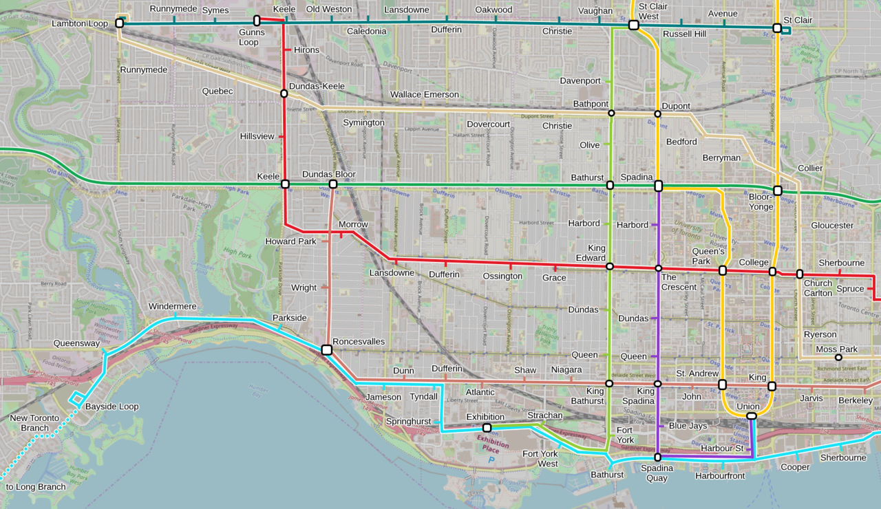

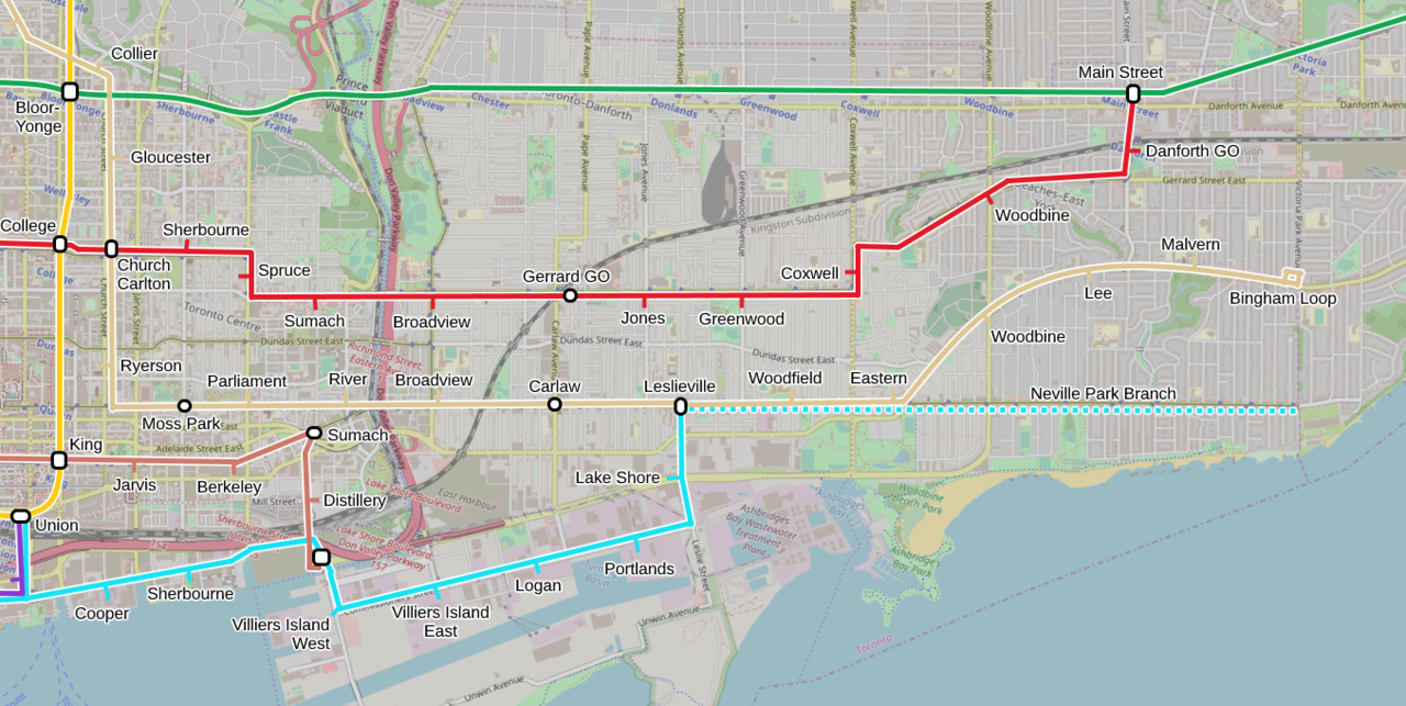

What if we made most of the downtown streetcar routes into LRTs? This is what I envision the streetcar network looking like with just some route adjustments, stop consolidation, and laying down new tracks in the Portlands and the West End. The stops are mostly approximate, meant to give a rough idea of stop spacing. the Waterfront line has two distinct services, one from Long Branch to Leslieville, and one from Park Lawn to Neville Park.
Dundas and Queen West would probably still exist in more or less their current forms, except both terminating at Broadview Station. The unnamed station next to the Keating Channel could be the terminus of the King line, but it could also be a simple shared stop with both lines continuing to Villiers Island. I also altered some of the streetcar routes to anticipate future subway expansions.
I like that you have added a line to Dupont.
Dupont's potential has been on my mind for a while, it is a subtle corridor not thought of much in our transportation paradigm, being north of Bloor and along the rail corridor, but it is seeing quite a bit of development activity and intersects quite a few residential neighbourhoods.
To demonstrate it's potential, it is fun to turn on satellite imaging on Google and rotate the map of Toronto so that Lake Ontario is aligned north-south. Like this, you can see that the Dupont corridor features rather prominently as the border of our downtown area, and then transitions fairly seamlessly to Dundas West into the Junction.
Asides from Dupont, I think that the section on Queen between Yonge Street and Church Street should also have the LRT prioritization. No sense in having the westbound Queen streetcars get stuck in traffic right before their most important interchange point (Queen Station).
Ideally the Queen line would still have prioritization east of Spadina, I just felt that if the King line was completely prioritized then there would not be as much incentive to do the same thing for the Queen line where they are 300 meters apart. Also, I think the Queen subway line should continue underneath Queen Street West to reduce the need for LRT prioritization.
