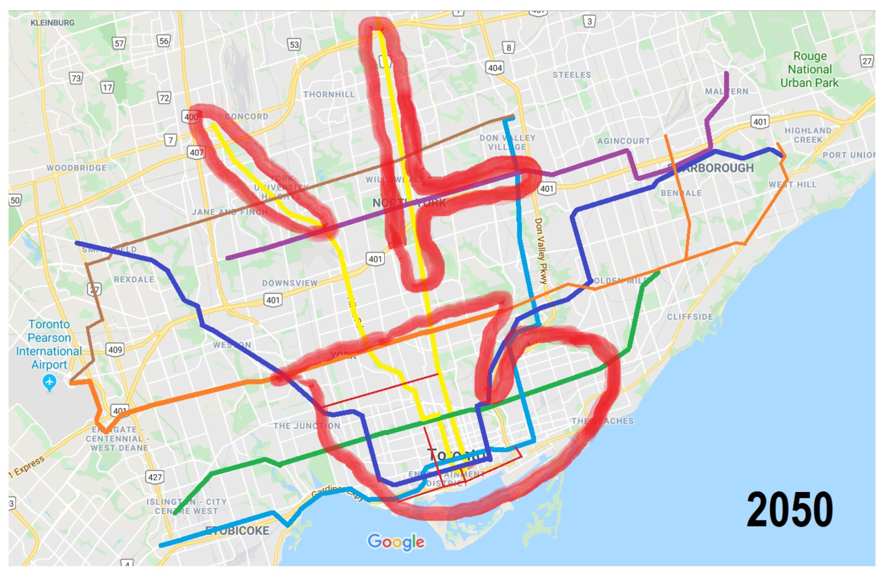

I think I have too much work in the East in the 2030's (finished on 2040), and too much in the west the following decade. But here's the idea.

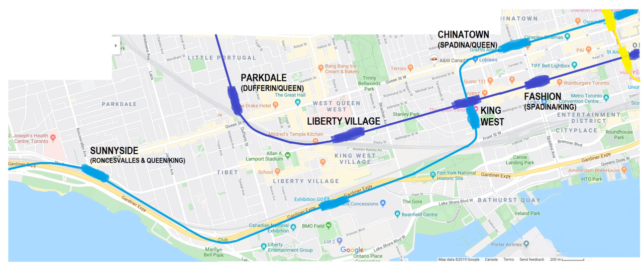

Some details.

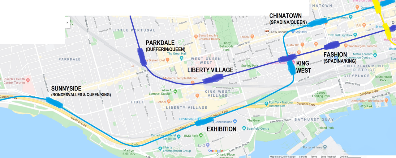

1) Downtown. The King Line would go up Dufferin - completely underground. The Ontario Line would follow close to the current alignment - but maybe immediately south of the Gardiner (instead of above the GO). Like I said before, as long the transfer is no worse that Union - City Hall bound passengers would transfer here. I cross the Ontario line (elevated) north of Gardiner for a Station at Sunnyside for transfers to/from major streetcar routes. It then crosses back to the south side.

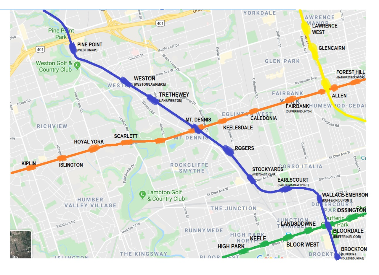

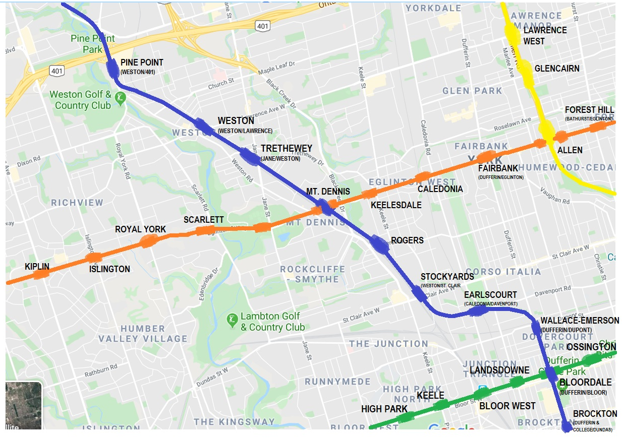

2) Farther North, the King Line basically switches from Dufferin to Weston Road at Davenport. Between Rogers and St. Clair, the line would move from underground to elevated - and stay that way for the rest of the route northwest. Interchange Station at Dufferin/Bloor, St. Clair and Mount Dennis - and with FWLRT (beyond this map). Continues over/beside GO corridor from St. Clair to almost 401. The one thing I'm maybe least happy with is that this parallels the GO corridor for about 6km - but that rail corridor does provide the opportunity to switch from underground to elevated.

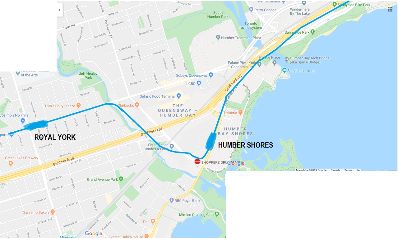

3) The Ontario Line continues West along the Lakeshore - I don't foresee any stations between Parkside and Humber Shores, which is a bit long at 3.5km. I thought about 2 Humber Shore stations, but that would maybe just be inconvenient for the majority of the people. The other thought was a stop at Sunnyside Beach, but again not sure if it's warranted.
The Ontario line take Mimico Creek to get up to the Queensway (there's no other convenient point farther west). Likely 5 stations on Queensway at about 1km spacing - Royal York, Islington, Kipling, East Mall, Sherway.

I think any line that goes along Queensway would have to be downsized to remain in the realm of possibility. So perhaps a two-car setup for accompanying two-car sized stations. Could still be part of the RL though, running along its downtown section. But as its own separate service. I'd even envision it going east and terminating at Hearn, cuz who knows what could be there in thirty years.

Assuming OL is build as planned, with the western terminus at the Exhibition and pointing west while being above ground, that will create a strong push to extend it further west using the LS West rail corridor, and then serve the southern Etobicoke. That's not necessarily the optimal extension, as the north-western options have their merits too, but the ease to build argument will be definitely in favor of continuing west on surface rather than ducking underground and making a relatively sharp turn.

I think a station in Swansea/Sunnyside (at Windemere) is valid.

I don't think smaller trains can get a share of track time in the OL downtown tunnel.
They want to run at 90' headways to provide the required capacity. Probably won't entirely succeed and will have to accept 105' or 110' headways instead, and the capacity will drop from 34k to ~ 27 k. But, what happens if they allow smaller trains to take 1/3 of track time? The capacity will go down to 22 - 23 k, which is certainly too small.

There should be a stop at Windermere for the Swansea community.

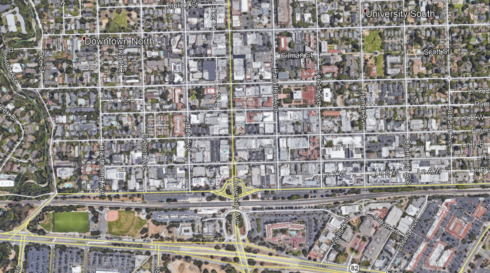

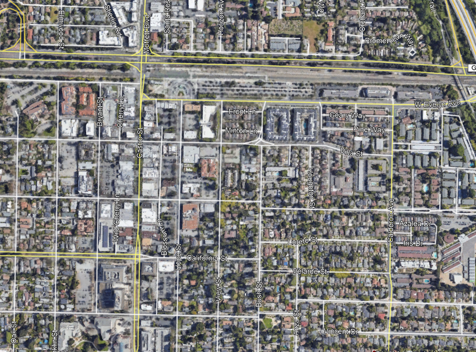

IDK what the right place to post this is, but how come the province doesn't do transit oriented development and zoning with regards to the GO Trains similar to how the Caltrain functions in the bay area?
In California, you get little downtowns clustered around these Caltrain stops like these examples from San Mateo, Palo Alto and Mountain View

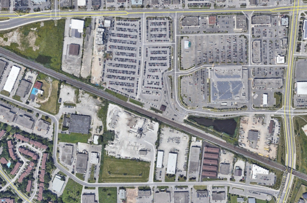

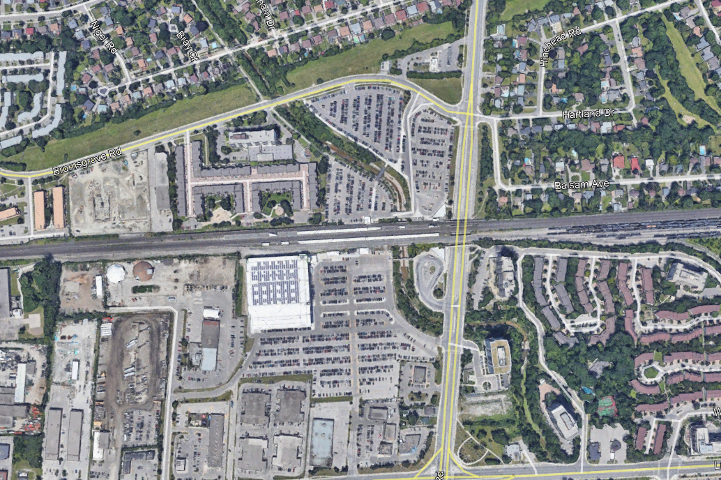

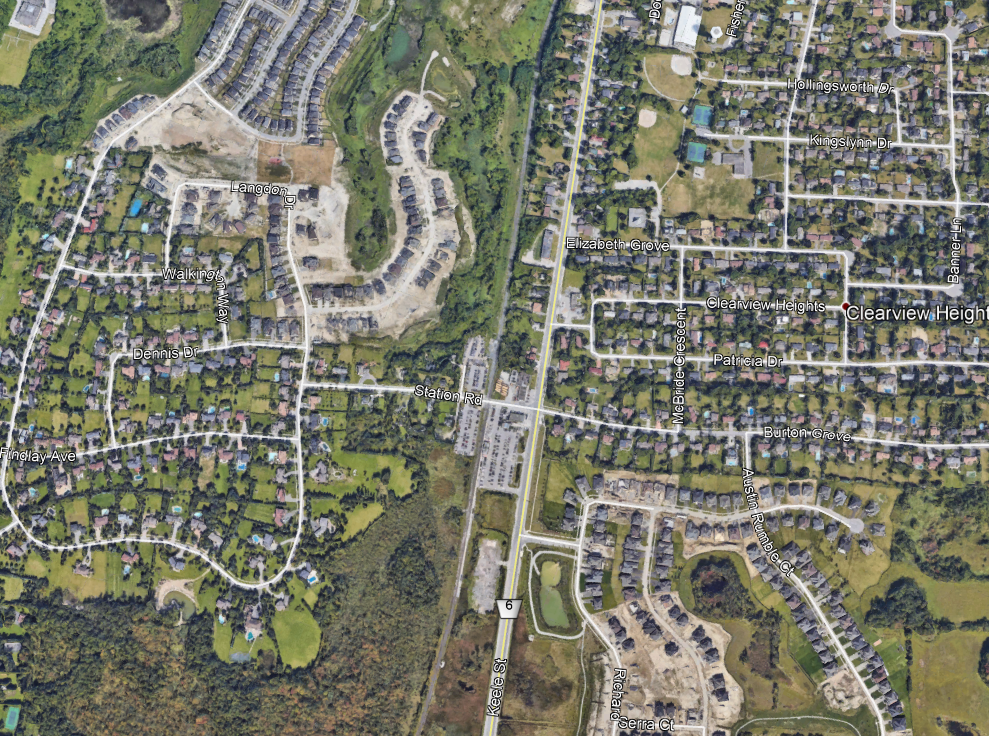

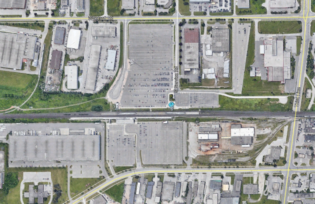

Put that in contrast with what we have around GO stops in Mississauga (Clarkson GO), Oakville , Milton, King City etc.

Well, Metrolinx has identified all these GO stations as mobility hubs / major transit station areas (MTSAs) with specific intent accomplish what you speak of in the long-term. Planning in this province moves at a glacial pace though, so throughout the region we are still waiting for the various municipalities to adopt these mobility hubs into their Official Plans as they are obligated to do (many are resisting for as long as they can, for example, refusing development applications around existing GO stations for being too dense, citing that MTSAs are not currently listed in their official plans, so there is no planning basis for high-rise towers, etc.).
In the short-term, Metrolinx also has to deal with the competing usage of the GO station parking lots for their customers.
Another major issue is that many of these station areas are geographically challenging, have existing residential built form patterns that are incompatible with intensification, or are in provincially designated employment lands which are protected in our planning regime (and that is not necessarily bad thing, you don't have residential development without jobs, and industrial lands throughout the GTA have very low vacancy rate). The areas along the Caltrain you screenshot seem to be areas that were developed during the heyday of rail (just guessing, I might be wrong), and seem to have existing urban structure and street grids to match. That urban structure in contrast, is amenable for intensification.
