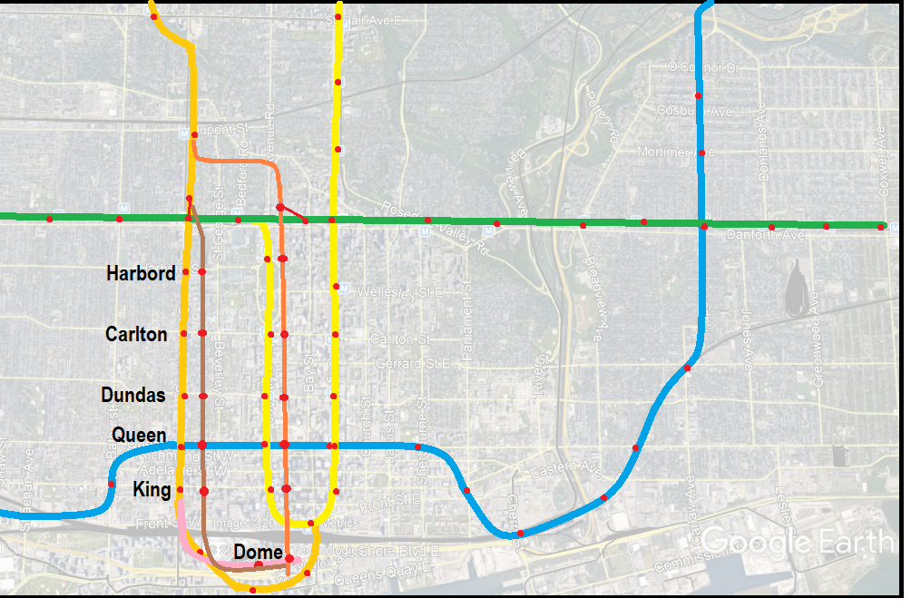

I like the Bay Express subway concept in general, but not sure it can go that far south. The problems are the conflict with PATH, and the water table issues when the line gets close to the lake.
How deep are the PATH crossings - I suspect not very.
I doubt the Bay Line would be at a lower elevation than the current Queens Quay LRT stop.
Assuredly there'd be a stop at Harbord. Front and King could be consolidated into one stop (Clarence Sq being the southern exit). Here's an idea for replacing the 510 with an extension of the Spadina Subway. The Yonge-University Line now ends at St George Stn:
This hits many nodes en route: U of T (a PATH system could even connect the Harbord stop directly to Sidney Smith and Robarts), CAMH, Kensington Market, Chinatown, Fashion District, West Queen West/SoHo, King West, CityPlace, Rogers Centre, Harbourfront Centre, One York, Queen's Quay Ferry Docks, Weston Harbour Castle, Scotiabank Arena/Jurassic Park. It's also very complimentary to the Ontario Line.
To my understanding:
- Line 1 mezzanines and the PATH are mostly at level -1.
- Line 2 platforms are at -2.
- Ontario Line will have to go under Line 1, and thus will have platforms at -3. The depth of OL at Bay can't differ much from its depth at Yonge or University.
Thus, if we are OK with the future Bay line ending at Queen, then it can run at almost any depth. If we want to reach King, then we can't use -3 because of the conflict with OL. We have to ether thread it at -2 and fit above the OL but below PATH and most of the utilities, or go for super-deep at -4. If we want to reach Union, that's basically same except a longer tunnel and more utilities to clear.
The current Queens Quay LRT stop is very shallow and has no mezzanine. TTC definitely prefers subway stations with mezzanines, although perhaps that requirement can be lifted once.
Anyway, the main problem is that the existing streetcar loop is at the same level as Line 1 platforms. If we want to extend the future Bay subway line to south of Union, then its Union station would have to be much deeper in order to get under all the structures. That means either a deep Queens Quay station as well, or a large change of depth between Union and Queens Quay. That might still be doable, but certainly adds a great deal of complexity.
If the Waterfront streetcar system is upgraded and the existing loop expanded well before we start dealing with the Bay subway line, then it will be very hard to justify the rebuilding of something that already works.
I think the mezzanine requirement is considered a lesson learned from the original Yonge stations.
King, for example, has tons of exits but any passenger wanting a specific exit (and not clever enough to board near that exit) will walk the length of the platform causing congestion. If there was a mezzanine, they would go off the platform with the flow of the crowd then find the exit they wanted.
Finch has 40% higher ridership than King but passenger flows are much much smoother. Imagine if the TTC bus, York/GO Bus, and south pedestrian exits each had a specific platform level stairwell to use.
To be useful, that line ought to.go north under Bay from Union to at least Queen, and perhaps further. Makes no sense to force a transfer at Union, (that moves the point of peak overcrowding from Bloor to Union) and the end destination of riders coming south may be too far east of Spadina and too far north of Union to be walkable.
