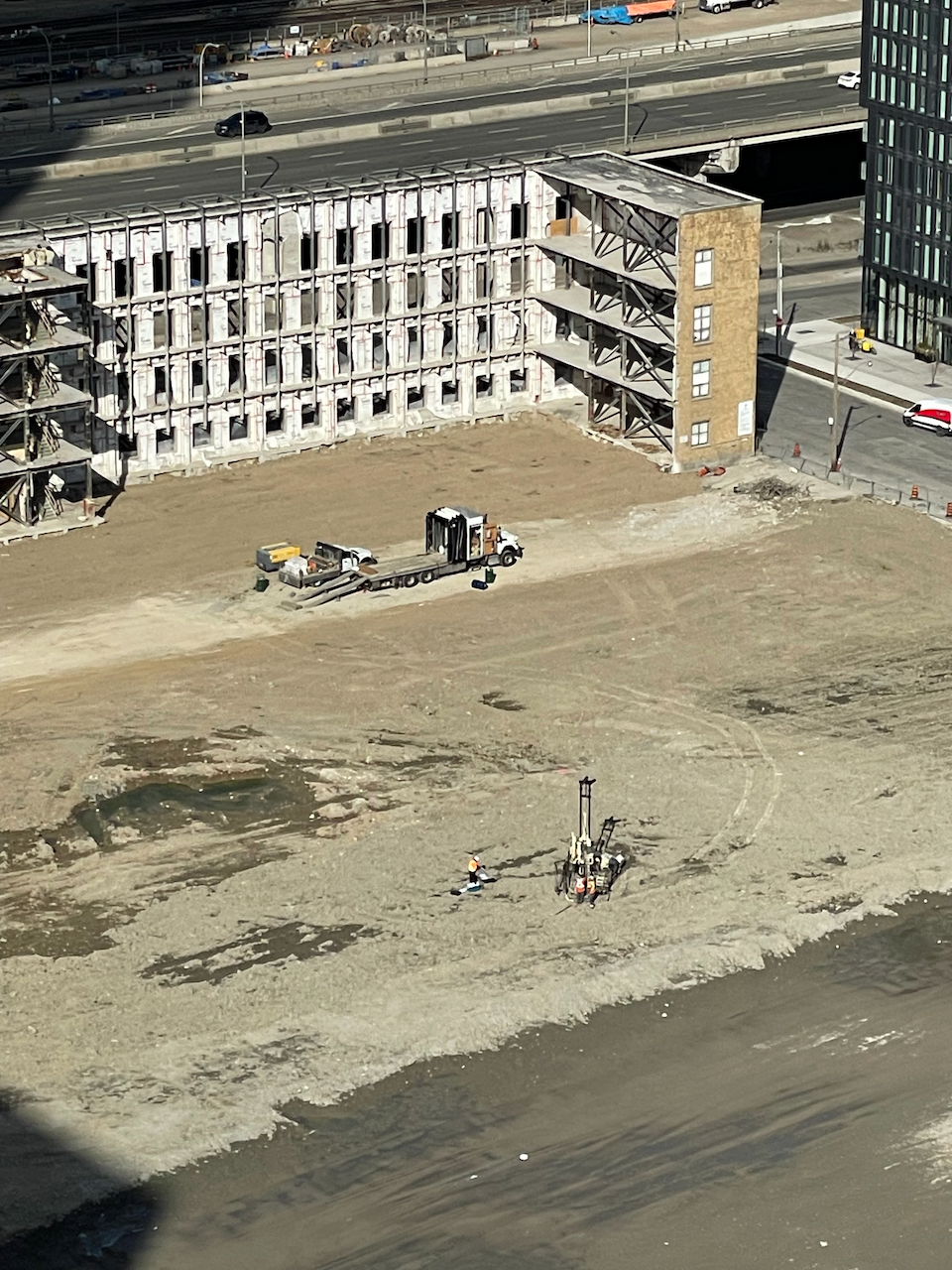

Taken this morning at 8.30 am
...I guess they had a lot a of weird things sitting in LCBO storage and what not if leaked into the ground could cause future residents to sprout new limbs or organs. So gotta take care of that first!
