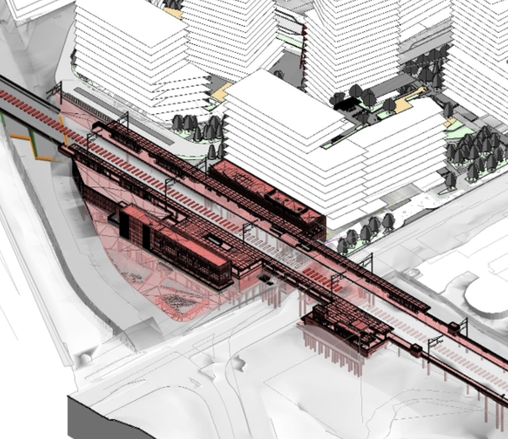

That design appears to complicate any option to run additional tracks thru the Gardiner underpass on the north side..... although the centre line of future tracks is shown, not much is done to rough in the necessary guideway.
Do you mean this? How long ago was that built?
It appears aligned with where the future tracks would go, not understanding the complication?
Maybe I'm overthinking/misreading, but it's not clear how much of the structure is at track grade where the two added tracks would go, and is what's being built intended to support those tracks, or would ML have to come back and install supports or move what's there in order to put in a guideway over the station. The tunnels and head structure on the northeast side have clearly been spaced to allow the added tracks, the west side structure appears to sit right where the tracks would go.

@crs1026
I had a good look at the docs............I believe your interpretation is incorrect.
I have modified the architectural drawing below by highlighting in black the location of the new side platform.
The tracks would be interior to this location.
The new side platform is simply a smaller version of the one being built initially without any island platform.
So there are stairs and a canopy etc.
The tracks will go below (in this image) or to the south of the new side platform.
Screenshot 2025-01-16 at 12-57-05 PLN - Architectural Plans - ArchitecturalPlans_ParkLawnGO_SP...png
An alternate drawing and view:
Here I have again highlighted the final north platform edge; but this time I have highlighted the new tracks - centreline in red.
