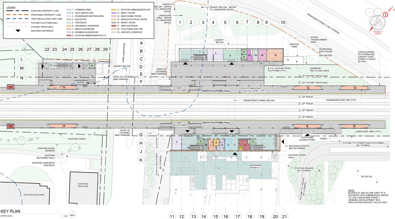

I don't have any insider knowledge about what these tracks will be used for but I'm interested that they're called out on the drawing.
I'd say a rerouted 501 is less likely because the site plan for the Cristy development shows streetcar track leaving Lake Shore West and routing alongside the GO station's south entrance.
Looking at Mimico GO station (immediately west of Park Lawn) it has 6 tracks, with 4 platform faces, which could suggest these 6 tracks would be extended through Park Lawn GO in the future to provide tracks for managing entry/exit from Mimico Yard.
The platform face (PF) configuration is not the same as proposed at Park Lawn (PF-PF-T-PF-PF-T vs PF-PF-PF-T-T-PF) but that could be reconfigured I guess.
The bridge carrying the QEW / Gardiner over the tracks seems to have space for at least 2 more tracks.
It is highly speculative, there is clearly not a network decision announced which would lead to any of these.
And the construction of said tracks would be a major effort, involving a new bridge over Mimico Creek, tunnelling under the Gardiner, and hefty construction along the Gardiner and west through Mimico.
It's enough to know that they have futureproofed the design for some as yet unforeseen expansion that is at best decades away.
I'd say a rerouted 501 is less likely because the site plan for the Cristy development shows streetcar track leaving Lakeshore West and routing alongside the GO station's south entrance.
Agreed, I could see that north platform shifted to the side of the corridor, but renders from the 327 Royal York Road entry suggest it was staying status quo. Were there any development plans published?

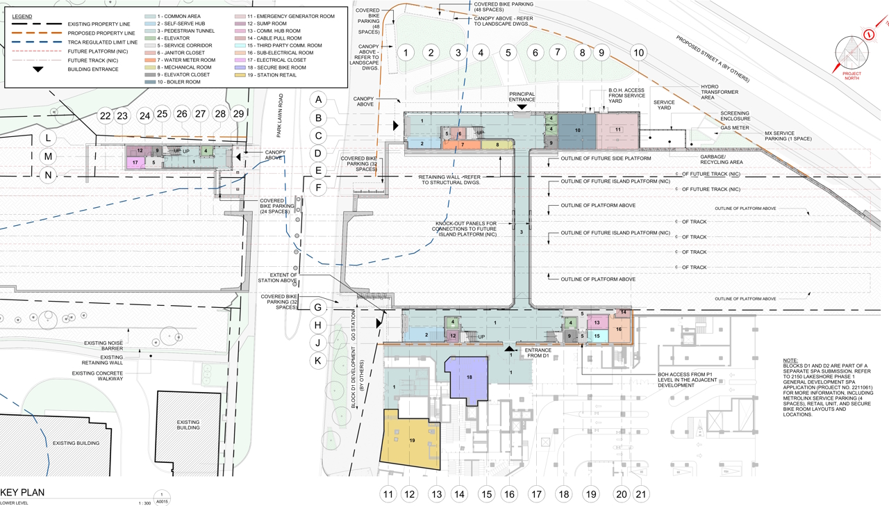

There's provision for 2 Future Tracks (with the North platform becoming an island) but I don' see any indication if these will be additional GO tracks or Ontario Line tracks.
GO's ultimate plans call for 6 tracks from Bathurst to Mimico, with the 5th track being a somewhat more short-term vision.
Dan
That design appears to complicate any option to run additional tracks thru the Gardiner underpass on the north side..... although the centre line of future tracks is shown, not much is done to rough in the necessary guideway.
