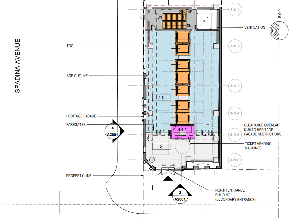

The North-east entrance will be an elevator only entrance with a bank of 7 elevators and emergency exit stairs. These elevators will take passengers down to the mezzanine level above the platform with another set of elevators/escalators/stairs to get to the platform:

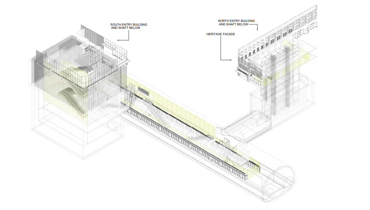

The South-Western entrance is the primary entrance with elevators, escalators, and stairs. There will be 4 landings before getting down to the mezzanine level above the platform and another set of elevators/escalators/stairs to get down to the platform:
Here are a couple of 3D renderings of the final design:
I count 5 banks of escalators from Street to Mezzanine level and 6 banks from Street to Platform level... I suspect the elevator entrance will be more popular
It has changed from 5,6 to 4,5 since these drafts were released, according to one of our insiders:
They increased levels height and removed 1 from the tender design.
