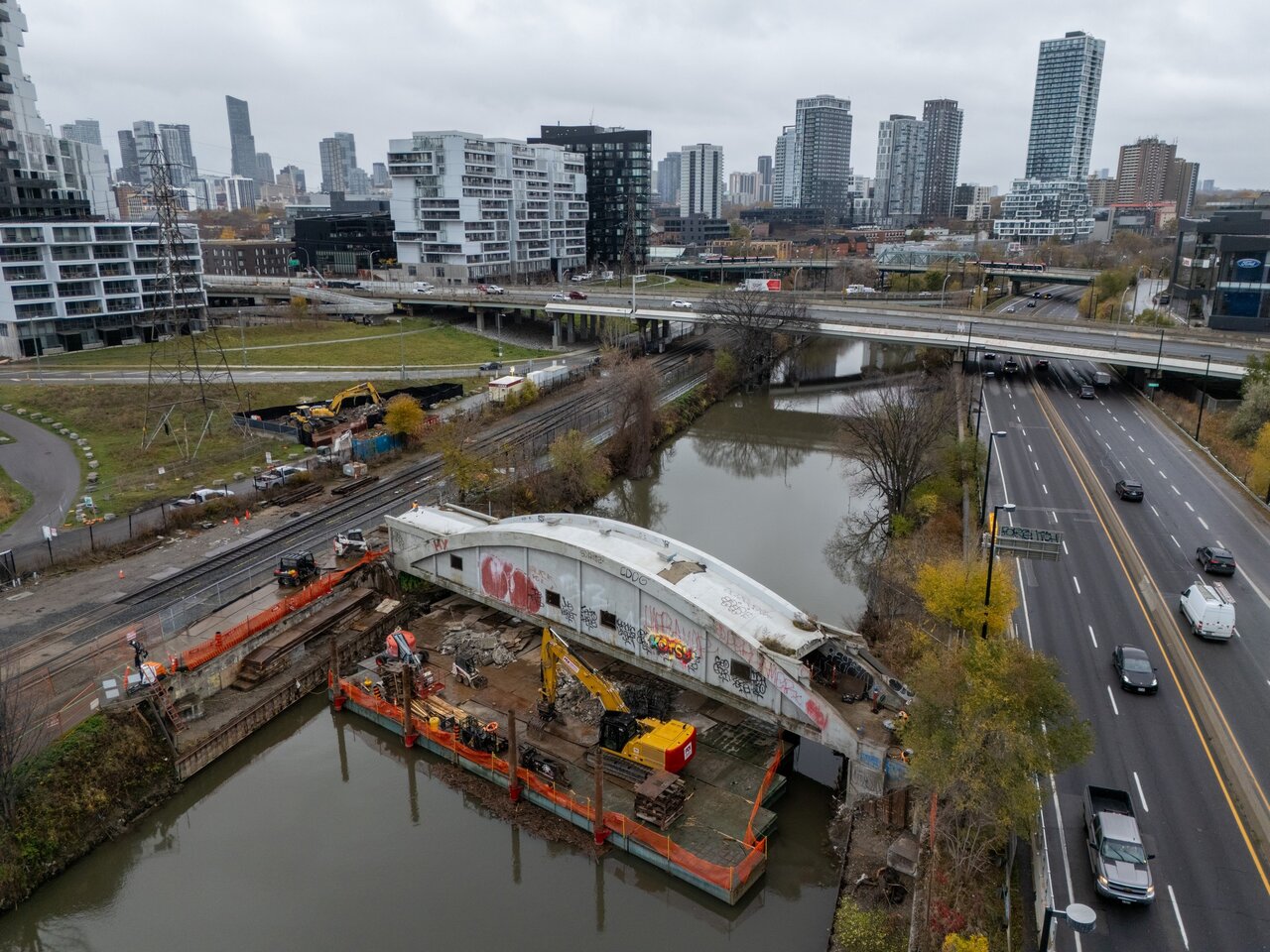

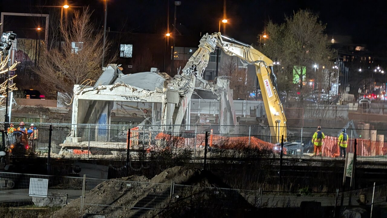

bridge demolition update from the 22nd.
The Drum118 Bridge still seems to be taking forever with no progress, but again I'm probably missing massive progress that's staring me right in the face.

Can anyone tell if this bridge is now disconnected from either side and resting entirely on the barge under it, or not yet?
I strongly doubt they would 'disconnect' the bridge until it is reduced to a skeleton and see no reason why they would want to.
