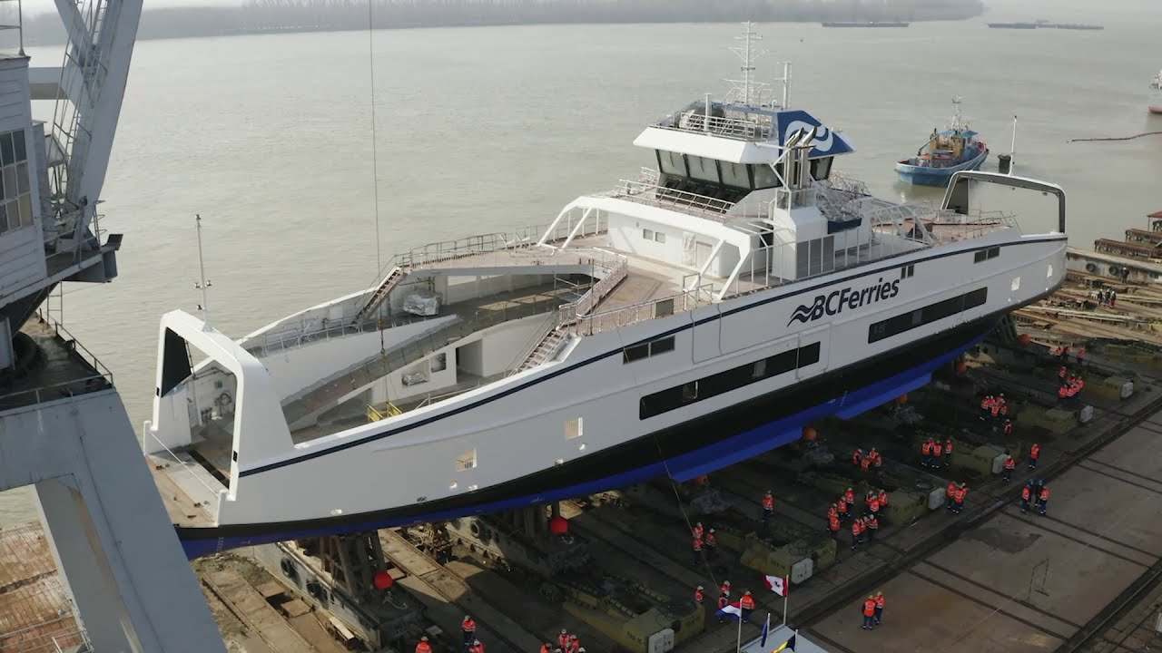

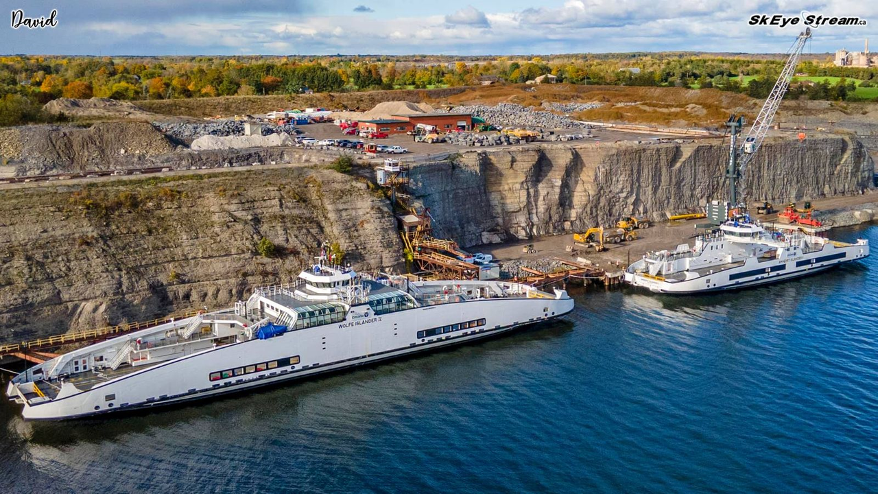

Interesting that both the Ontario & BC Provincial governments have ordered from this shipyard previously, and it does seem to have experience in electric ferries:
While these are RORO vehicular ferries, I do hope that we get a design that resembles the current ferries, with large open upper decks.
