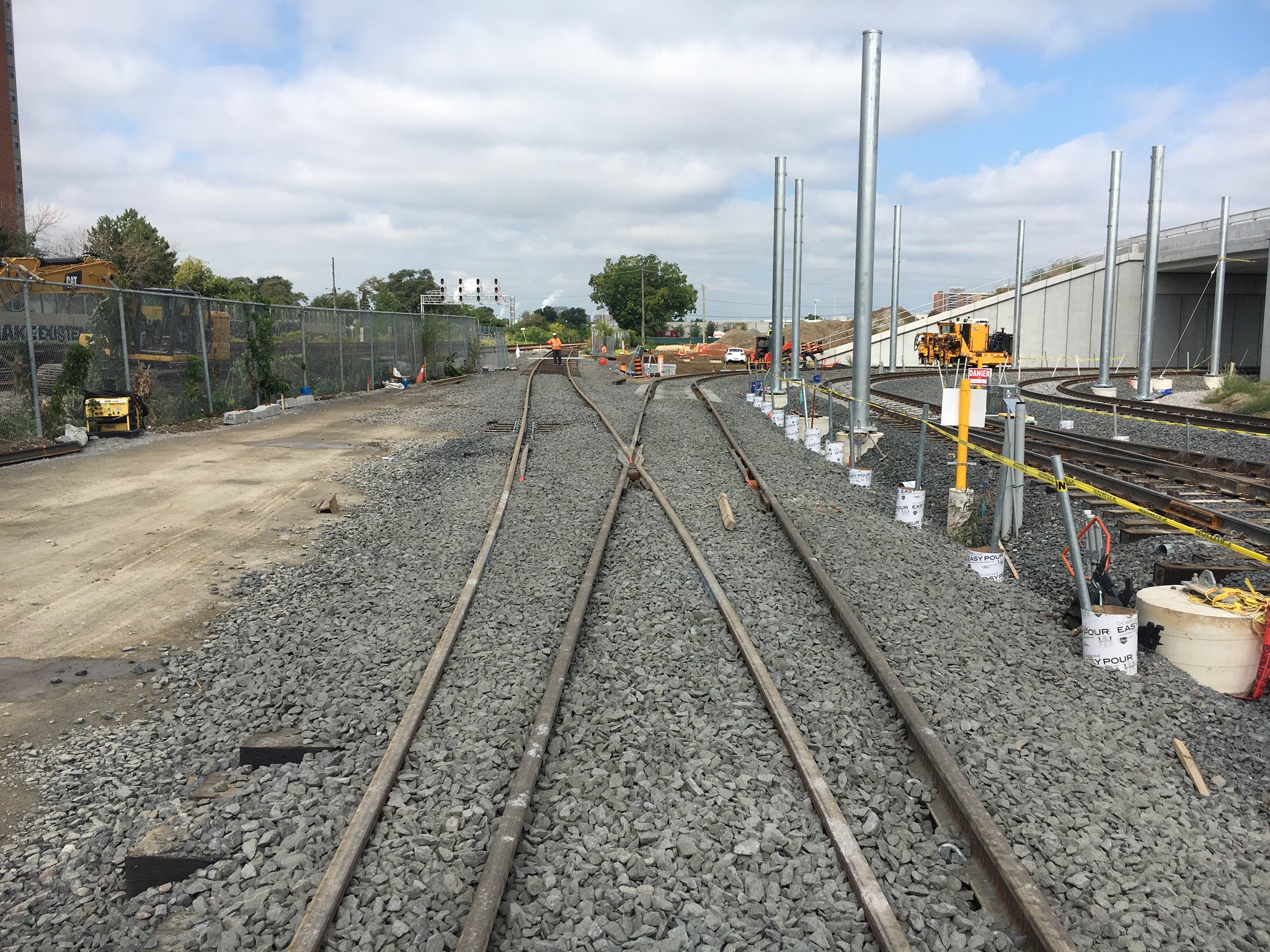

That being said, I guess the Crosstown is now technically connected to the transcontinental North American railway system? I know it is just a technicality, but a cool one at that.
It certainly has echoes from the past where city tram systems often were connected to mainline railways for onward delivery of freight cars. Often the street railway would have 'electric mules' (locos) to do this. Guelph had two yards for the purpose. One with GWR, and one with GTR.
Memories....(lol...from well before my time). Btw: This is the best theory for the TTC gauge being born: Toronto not wanting that kind of integration of 'street railways' with mainline ones.
Except that the theory falls apart when one considers that standard-gauge railway equipment can operate - carefully, admittedly - on TTC gauge track.
For instance, with the exception of the connection track to CN and CP, all of the track at the Bombardier Thunder Bay plant is built to TTC gauge. They have no problems running BiLevels on it.

Yup. There is only a 6cm difference between the two - meaning each wheel is 3cm further out from the centreline of the vehicle.
This is pretty cool. I wonder what measures were taken during the removal of the precast segments.
Is that a true track connection, or just a spur into the EMF with a ramp (similar to Hillcrest)? I presume that the LRT vehicles will arrive on flatcar, not on their own wheels? Or are we delivering boxcar loads to Leaside?
I assume that it is a true track connection, and that the process to unload will be a similar to that of the ION LRT. See video below that @KevinT previously posted in the ION thread.
Thanks for the reference. Given the volume of cars the Crosstown's EMSF will receive versus Waterloo's system though, and the busy-ness of the line it's connected to, I think they'd be better off (and safer!) doing it Hillcrest style with a fixed earth and concrete ramp.
