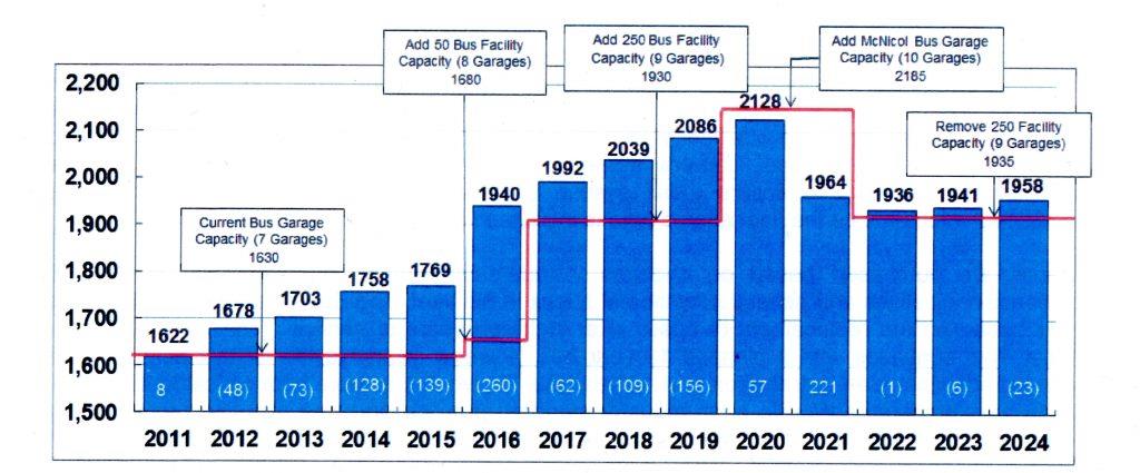

How many buses will ECLRT free? Enough to relieve some of the overcrowded bus routes?
Great question. Hard to calculate.
1. There's the obvious routes which run along Eglinton which would have a few dozen buses free'd
2. We don't have a bus order other than the hodge-podge of electric vehicles (that I'm aware of) and buses will retire due to old age around the time Eglinton opens; all those vehicles in #1 may simply be scrapped.
3. North/South routes intercepted by Eglinton may see their peak ridership point move north. Riders transferring to Eglinton leave space on a previously occupied vehicle. So, a single trip might move 2 people (one from Lawrence to Eglinton, and a second from St. Clair to Bloor) in the same space that previously moved 1; meaning fewer vehicles necessary for North/South service. It's very difficult to determine this ridership shift in advance so I have no idea whether it'll free up 1 bus or dozens.

On average, the life span of a transit is about 12 to 18 years. However, electric buses (including trolley buses) have a life span of 30 years. Since we don't have trolley buses (or electric buses at the moment), the TTC will still have to order replacements buses by the time the Crosstown LRT opens.
