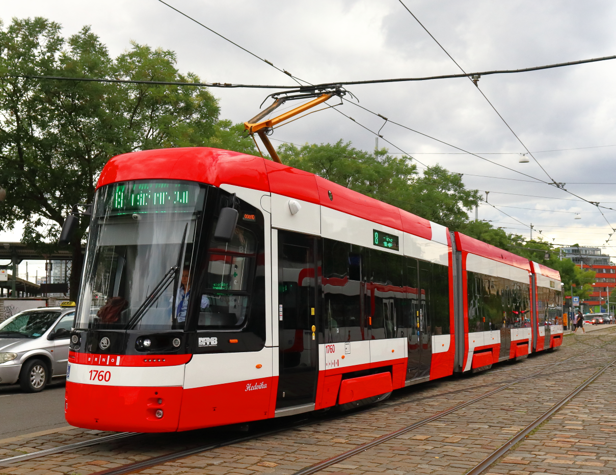

Skoda 15 T, 6 double stream doors for passengers plus a service door for the driver:

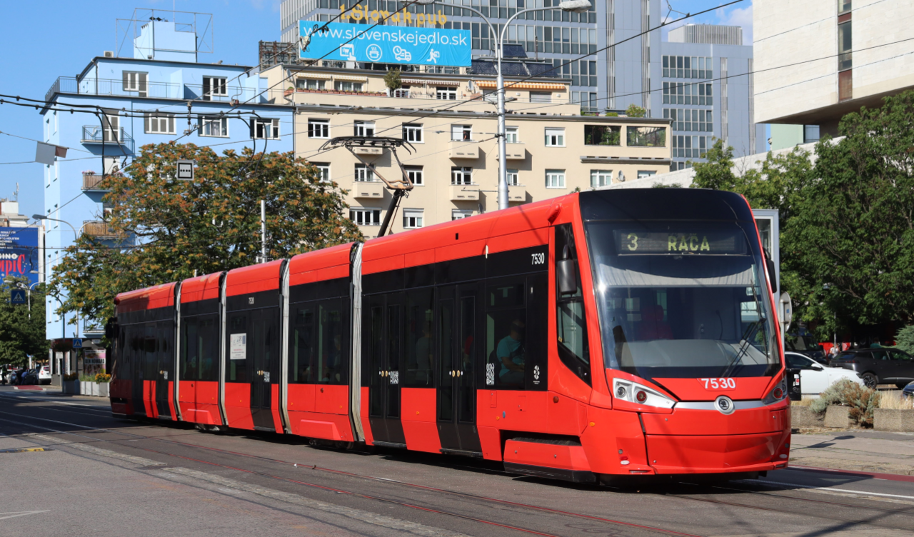

Skoda 45 T, 2 single stream doors and 3 double stream doors:
Skoda 13 T, 2 single stream doors and 4 double stream doors:
Skoda 30 T, 5 doors:
