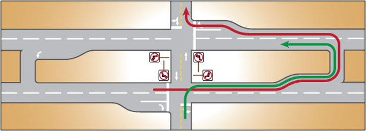

If ML had employed any planning on the Eglinton Line, which has become abundantly clear it didn't, it would have employed U-turn routes along the median of Eglinton. These are employed in many cities where there are no left hand turn lights at intersections but rather U- turns are made between lights using a separate lane and controlled by lights themselves........the cars can make a U-turn when there are no LRTs on the area of the route. Yet another failure on ML's execution of this line.

Since I guess you weren't around when those original conversations happened.....
The original planning for the line called for Michigan Lefts at almost all of the intersections. By the time they showed that to the public, the response was so overwhelmingly negative that they were removed for the EA.

I can see why they were rejected... it looks so complex just to make a turn, not to mention doubling up on the signalling for LRT crossing.

When you say that the Michigan Lefts were received overwhelmingly negatively by the "public", I can only assume that means a negative reception from drivers. More proof that Toronto put the needs of drivers ahead of the needs of transit riders.
How would Michigan lefts have helped, except in eliminating the nonsensical practice of prioritizing left turning cars over transit vehicles? If anything, it would make the problem worse, from the perspective of the LRT, because now you've just doubled the number of possible collision points. Left turns being given priority is a trivial problem; the far bigger one is idiot motorists that don't look over their shoulder when crossing a tram ROW.
I don't know how to make this problem go away. Rumble strips, maybe?
Get rid of those intersections for carsaltogether.

That would be ideal. However, would that make the problem go away at the major intersections? From my experience, people who have a general green (i.e. not a dedicated left turn phase), but are waiting for gaps in traffic, often do very stupid things.

The idea was that the signals at the major intersections was going to be simplified - there would be no need for dedicated left-turn phases, only straight through and right turns.
The Michigan lefts were going to be paired up and signaled, but the signals would be set up so that they would have to wait for an LRV to pass before triggering.
