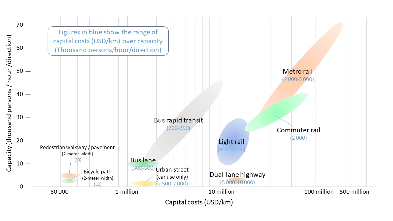

I always mention that a rail line cost more to operate than a bus route. Why did you think David Miller threaten to shut down the Sheppard subway?
When the Sheppard line opened it was overbuilt. It wasn't replacing a bus fleet capable of transporting subway capacities down the entire length of Sheppard, it was replacing a smaller 5km stretch with much less capacity. Only when the capacity is at a certain point is the mode of greater scale cheaper to operate. This is a chart of capital costs, but operationally things are similar where as you increase the number of people you are trying to move, the costs of operating a mode of transit not designed for that capacity becomes more expensive... it becomes more expensive to operate buses than to operate an LRT or a subway once you are trying to move a capacity that is reasonable for an LRT or a subway.
The design capacity of the Eglinton and Finch lines were optimized for a capacity that the line will actually see, so it will be cheaper than buses.
A Porter Q400 is cheaper to operate than an A380, but if you are trying to move 500 people from Toronto to Los Angeles, it is likely cheaper to put them all on the A380.
