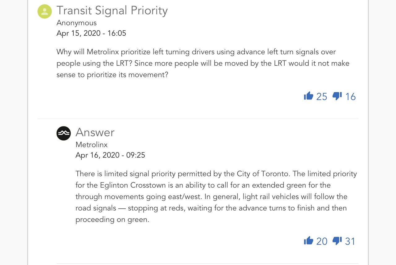

Why dismiss the entire article? The point about Metrolinx trying to convince Toronto to allow proactive TSP, and Toronto not budging on the status quo was accurate. If BlogTO's readership understands how much their own city's department is working against them, as we already see on Spadina and on St. Clair, all the better.
The 510 is lumbering, kneecapped garbage, but it doesn't need to be. Same goes for a partially at-grade line 5 LRT.

If issues exist on the surface section, we know exactly who to blame (hint, it is the City of Toronto).
What is preventing them to let through traffic go before left turns? The light at Lake Shore and Windermere is setup like that.
I'm trying to remember, I haven't been in the city much by car since COVID hit, but yes, Lake Shore and Windermere (I think it was Ellis or Humber Station which also use it) use the lagging FPLT, a rarity in Ontario. I'm no traffic engineer (at least yet) but I've always wondered why they are reluctant to use lagging FPLT especially in transit ROW situations.
Again, one of those streets, it's either Humber Station or Windermere uses lead/lag FPLT, that is one side gets a leading fully protected left turn, and at the end of the cycle, the other side gets a lagging fully protected left turn.
Someone explained to me once the concept is based on "driver expectancy", here in Ontario, we always expect a protected turn, whether it's FPLT or PPLT, to be leading, that is to occur before the main signal (generally for going straight) turns green.
Lagging PPLT movements are incredibly rare in the city on a side note, I think Lake Shore/Yonge is the only example I can think of, except in that case, the protected turn doesn't protect against oncoming traffic but against pedestrians.

The reason for no lagging left turns is that the decision-makers (AKA Canadian oligarchs) do not use public transit. They use gas guzzlers, where they are the only people in them, and MUST get priority over all other peasants in transit vehicles.
Well, lagging left should be beneficial to more drivers, as most drivers continue on straight then make a left turn at any given intersection. The main issue for lagging left (that’s fully protected) I think would be for queuing left turn vehicles potentially ending up beyond the left turn bay into the regular lanes, a leading FPLT allows the left turn bay to clear before the main green starts allowing the left turn bay to be filled again.
As I understand, the only other time you can squeeze a green in for a transit ROW would be between the barriers, that is when the intersection is under red clearance (also known as “all red”, when every light in the intersection is red)
