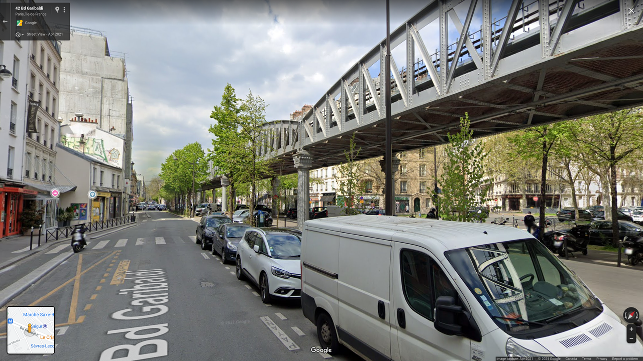

Elevated Lines just like anything else are only hideous if built that way. There are plenty of cities that have built Elevated Lines where they look perfectly find and nice: Toyko, Sydney, Montreal, Vancouver, Paris. Modern day elevated lines look absolutely nothing like NYC or Chicago. Looking at Chicago and pointing at that as an example as why Elevated Lines are hideous is the equivalent of pointing at NYC and using that as an example for why Subways are hideous and we shouldn't build them.
Paris Line 6 for Reference:
