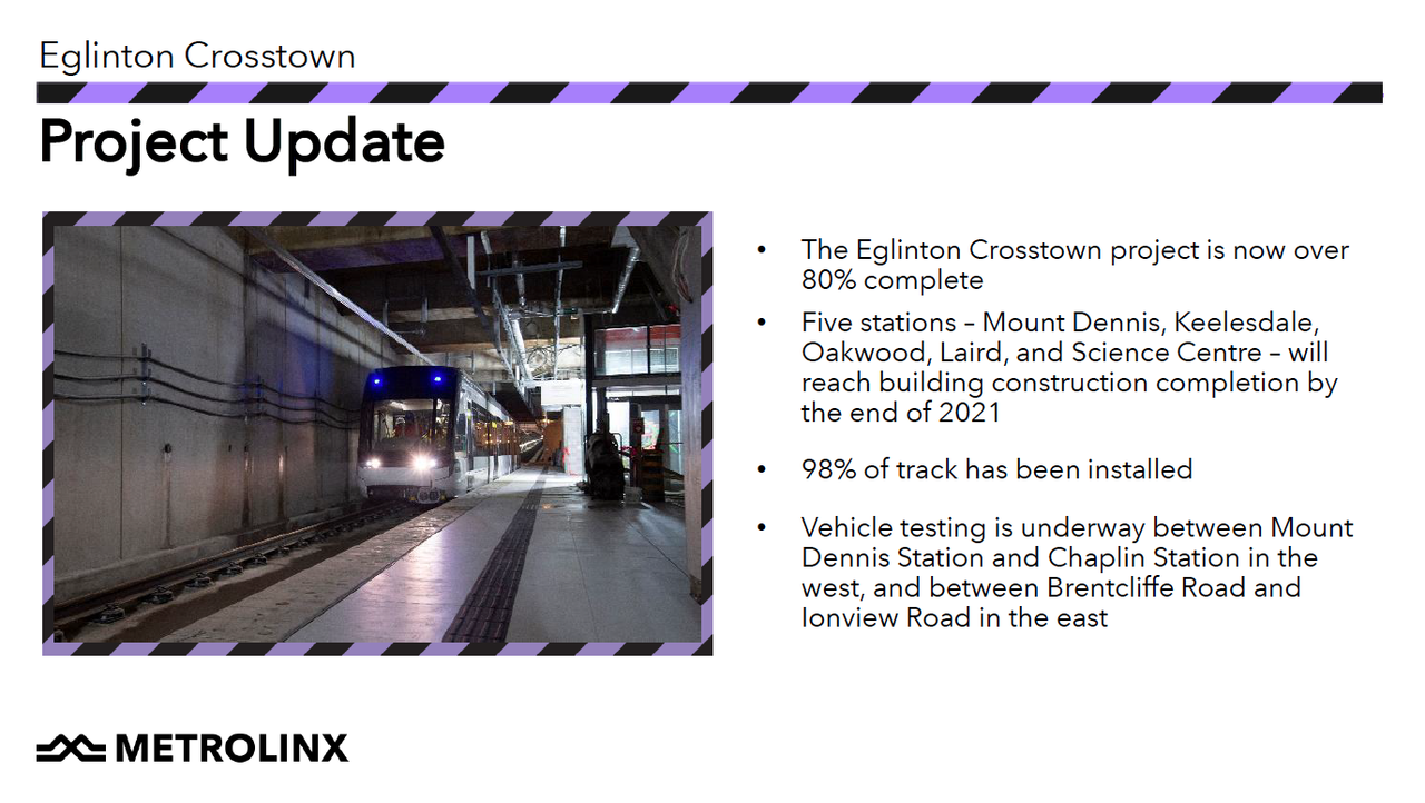

EGLRT Open House for Mount Dennis to Avenue Station started today for a week.
Link to Open House (Basically a place to ask your questions) - https://www.metrolinxengage.com/en/eclrtwestVOHfall2021
Link to PDF on update and status for the project from Mount Dennis to Avenue Station - https://www.metrolinxengage.com/sites/default/files/west_open_house_-_fall_2021_v8_1.pdf
Side Note - Seems as though the power point presentation is a bit dated because the tracks are now 100% complete and it states 98% complete so I guess they made it a couple weeks ago.
P.S. Eglinton to Kennedy Station Update will come out next Tuesday at 7:00 p.m.
Enjoy!
• 95% of overhead catenary system (OCS) installed
• OCS energized from Mount Dennis Station to Chaplin Station and from Laird Station to Ionview Road
• Tunnel lighting 91% complete, with work still ongoing between Avenue Station and Mount Pleasant Station
So they say they are almost done with the catenary too.
Also mentions trains are testing to Chaplin. Let's see how long till they can get them pass Eglinton.
