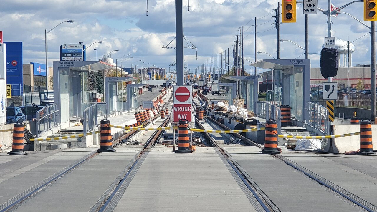

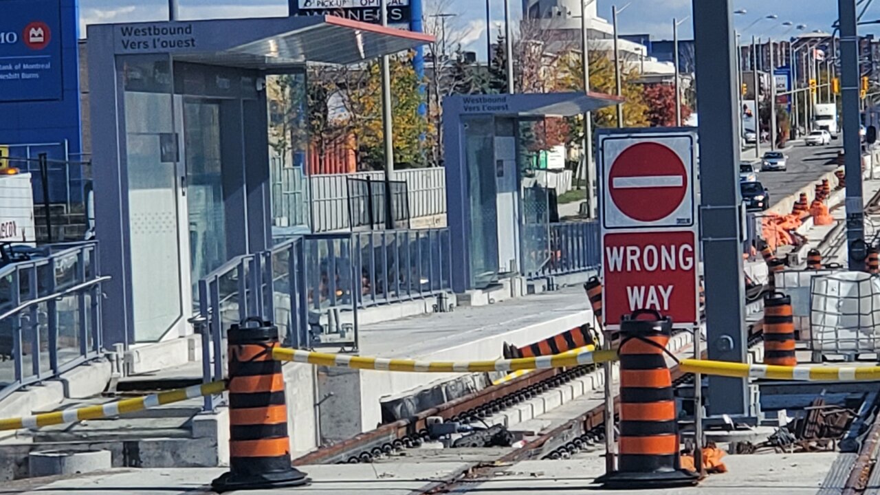

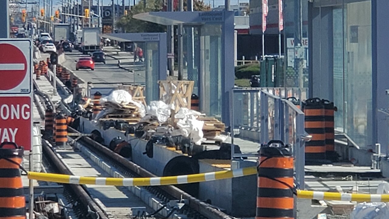

How will this work for the surface stops?

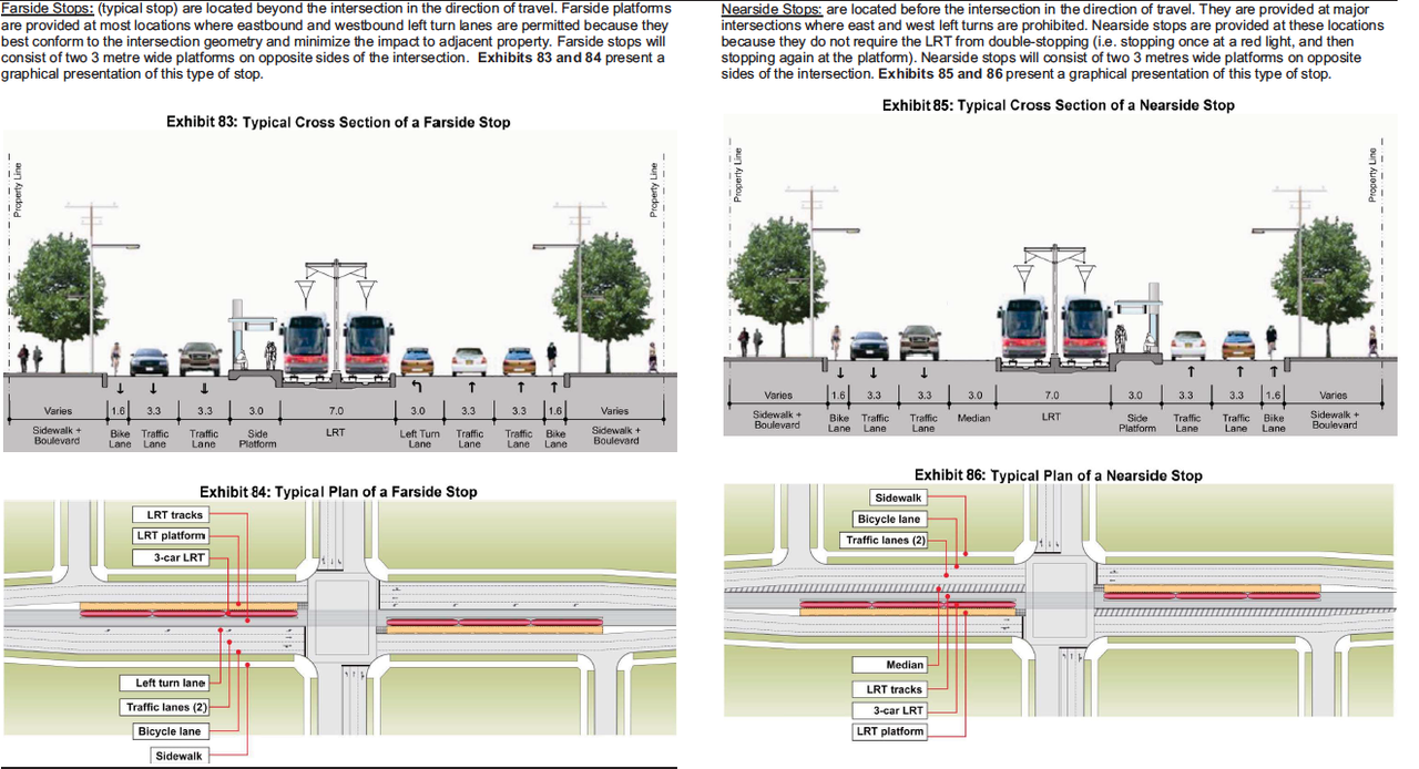

"Platforms will be approximately 90 metres long to accommodate three-car trains."
From link.
Guessing if they need more than the 90m, they'll just expropriate from the traffic lanes. 3.3m for traffic lanes is not needed, should be 3m to slow the traffic down to a more reasonable speed.
The challenge would then be running a sensible service plan, because it wouldn't be able to berth at Kennedy, Science Center or Laird. It would exclusively have to run on the surface section, and that would only make sense if most of the people are travelling locally. A 120m train will probably exceed the length of a pocket track, and would therefore have to foul the main line in a turnback.
If circulation inside the vehicles wasn't so bad, you could probably get away with selective door opening on the underground section and half a car overhang on each side of the station. But, anyone familiar with a streetcar knows how difficult it is to move between sections when it's busy.
