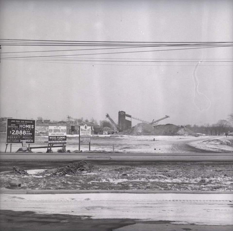

Mount Dennis is an old sandbar for Lake Iroquois, predecessor of Lake Ontario. Conn Smythe operated gravel yards in the area in 1958. Developed into Jane Park Plaza/Smythe Park. Smythe gravel yards were owned and operated by Maple Leafs owner, Conn Smythe. Many of the players would work in this gravel yard during the off seasons. Tim Horton in second photo. credit: Toronto Public Library. ‬

That's a great shot. Those three houses in the background would be 83, 85, and 87 Rockcliffe Street which still stand today:
https://www.google.com/maps/@43.678...try=ttu&g_ep=EgoyMDI1MDIxMC4wIKXMDSoASAFQAw==
