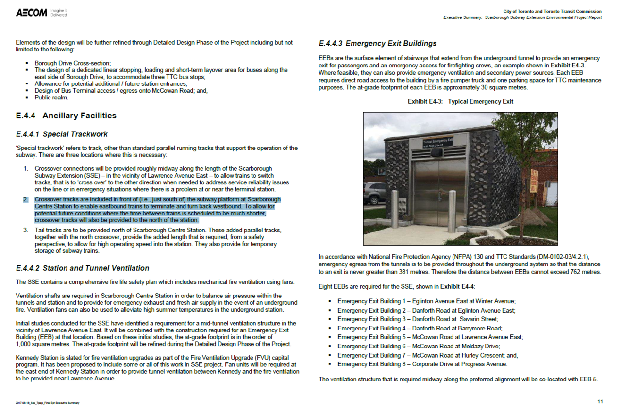

The problem is that this halves the stations possible throughput as now only 1 Kipling bound train can occupy the station at any given time. Secondly all it takes is 1 delayed train on the drop-off side and the Bloor-Danforth is crippled (we'll be turning back trains at Kennedy because SCC is unusable in this scenario). Having the crossover before SCC means that both platforms can have Kipling bound trains, and if one platform is out of use the other still remains. Functionally nothing changes as far as passenger movement is concerned but operational speed and efficiency is decreased and redundancy is reduced to zero.
I don't agree with that, side platforms with the crossover beyond the station allows for a greater number of trains per hour, an incoming train would just unload and go into the tail tracks, and then reverse direction into the loading platform, and take off when loaded.
Currently incoming trains are held up waiting for outgoing trains to go through the much longer crossover tracks needed with a centre platform station compared with a side platform station, leading to line ups at terminals.
According to the SSE EPR, Scarborough Centre Station will have crossovers immediately before (south of) AND after (north of) the station platforms.
