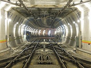

The crossover dosen't need to be that far out, it can be right before the station like at any terminus. You can see here in this picture of the Fukutoshin Line outside of Shibuya station that the X crossover is in the single bore tunnel. There is no reason this can't be done at SCC. It's only when the line splits into 4 tracks to serve the 2 center platforms that the line enters the Cut and Cover section.
