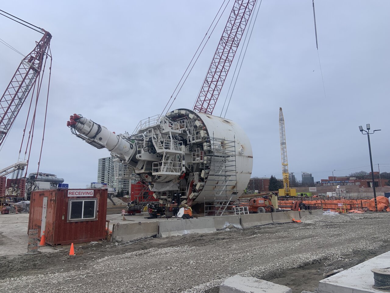

A tiny smidge of further progress..........

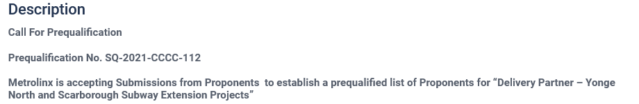

Not entirely clear what a 'delivery partner' is on this project.....

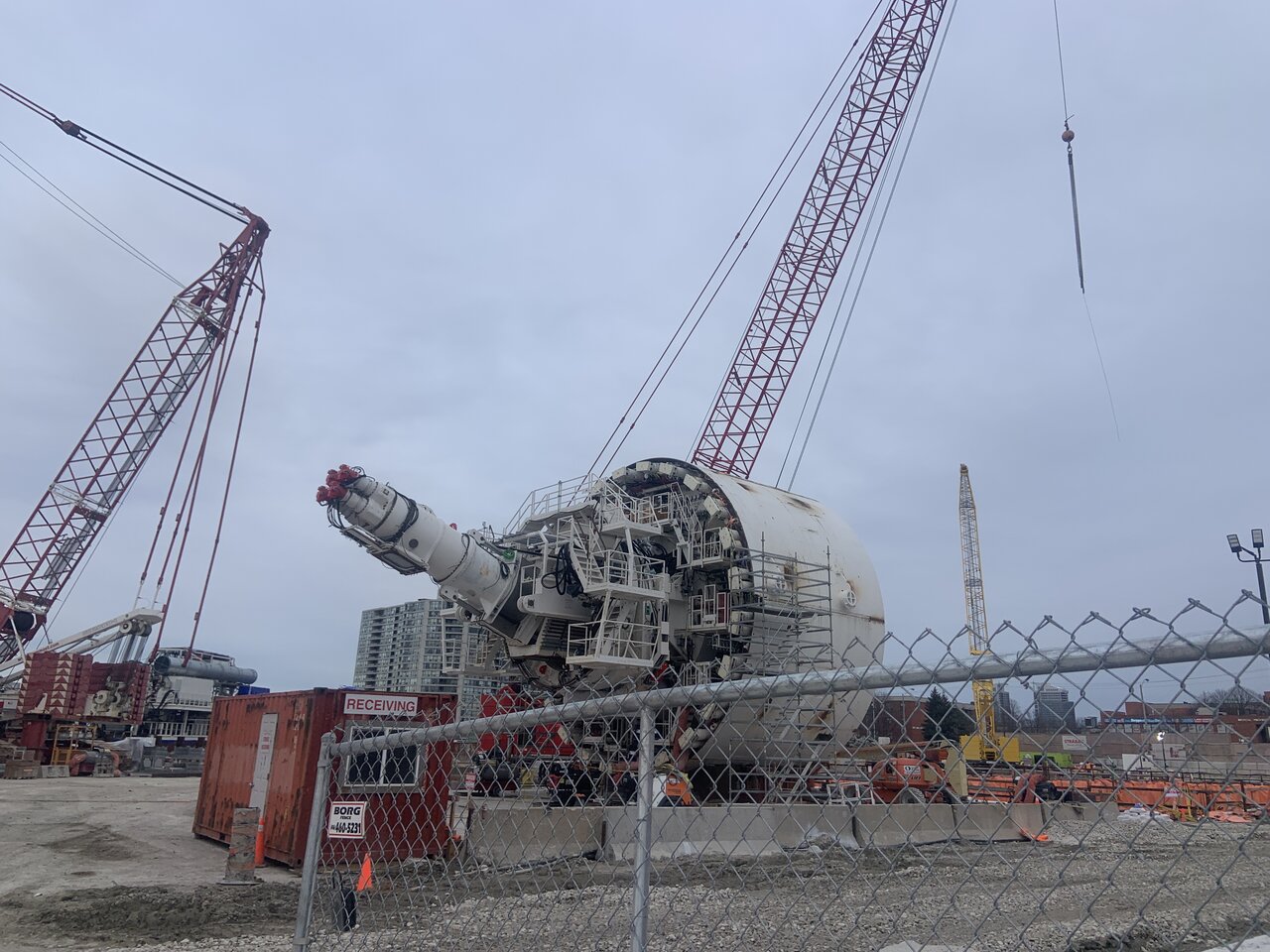

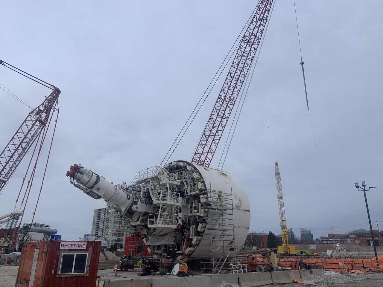

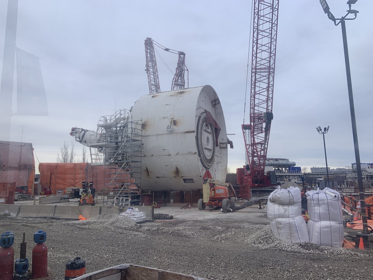

TBM is so big, once it's done you could place it permanently somewhere and turn it into a condo. So my question with a TBM this large is, once finished the tracks would sit roughly in the centre of the tunnel. What do they use to fill the space between the bottom of the tunnel liner and the guideways. Would it be solid concrete, or is there some fill used between? If it's pure concrete that requires a heckuva lot.
In general, I would assume both tracks will sit side by side in the tunnel section with one of the track rising to a higher level near each stations as the platform would be on different levels. The tracks won't sit pretty high up, it'll be close to the bottom so not a lot of concrete is required to fill to create a level surface. Assuming they'll built this like other subways in Toronto, a rubble puck is place on top of the surface to provide vibration isolation and then a concrete block on top. The rails would be mounted to those concrete blocks. A concrete emergency walkway would also be poured but that's not solid concrete. It's just a wall and a covering which allows cables to go inside.
I don't know the specifics for this project. They might decide to keep each direction on separate levels which would require a structure being built inside the entire tunnel. That'll definitely add to the cost. They might decide to build a wall to isolate each direction for fire control.
Wait, where did they say that the platforms will be on separate levels? I was under the assumption it will be like Montreal or the section of the Broadway in Northern Manhattan where its a big bore but still regular side platform stations.
I believe it's the latter. They're going to build a wall for fire prevention (kind of lame but whatever).
Regardless of where they put the trains, they most likely won't fill in any extra space. It's too valuable to use as possible conduit for utilities in the future.
