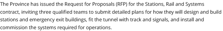

Presser out from the Province today that they have issued the RFP for stations, rail and systems.
From the above:

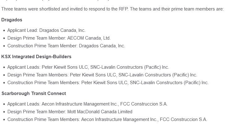

A refresher on the teams in question from the backgrounder:

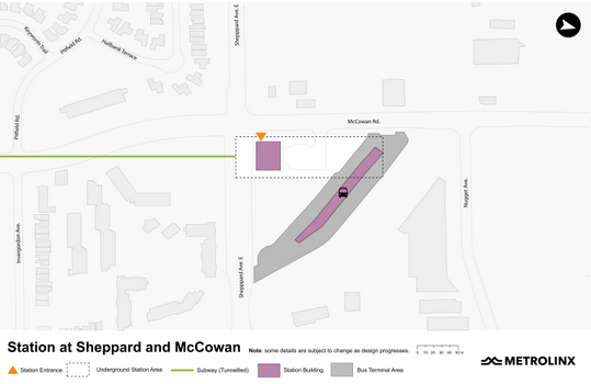

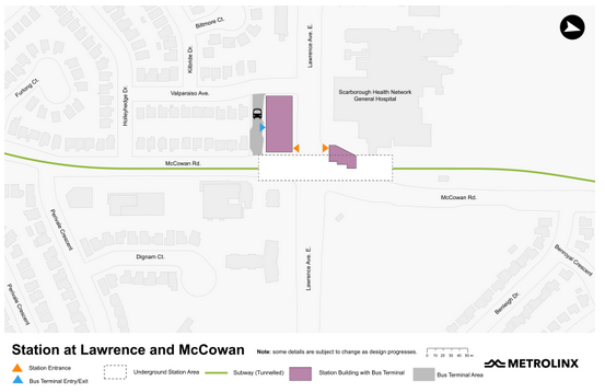

SSE update
1646678108566-png.383870
1646678085762-png.383869
Some want Line 2 Bloor-Danforth to interline or connect with Line 4 Sheppard. Guess it'll be at at Scarborough Centre somehow? Or maybe Sheppard will go with the light rail trains or Ontario Line trains (still waiting for that description).

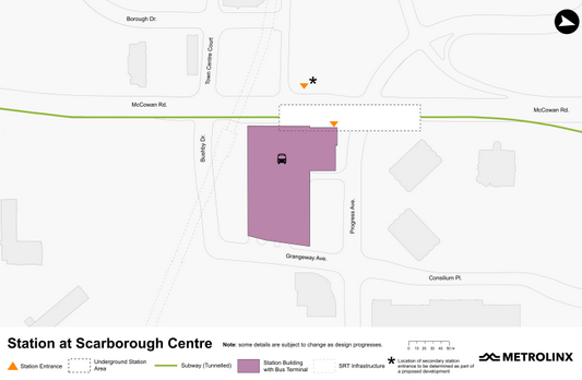

Looks like their plan allows for a northerly extension
With the station for Scarborough Centre now further east at where McCowan station currently is, do we know if there will be an indoor connection between the station and the mall?
