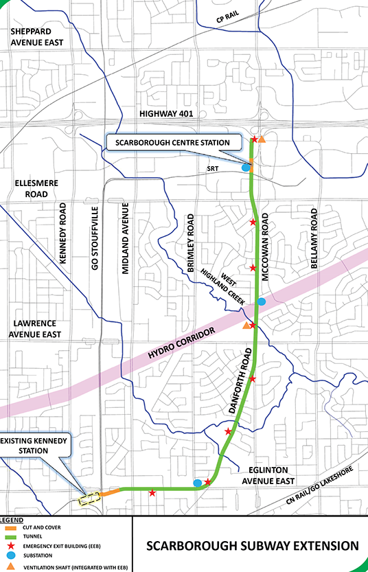

If they want a station, it would have to be a cut-and-cover line, so that there would be savings to offset the costs of the added station.
The question I have is, what to do with the 2 West Highland Creek crossings (Trudelle Park and Pringdale Ravine) south of Lawrence. The southerly crossing looks quite shallow, and likely the line would have to go under. The more northerly (Pringdale) crossing seems to be a somewhat deeper valley and it may be possible to build a bridge with subway below - but I suspect that even here you may have to go under.

I also imagine they considered it and ruled it out. Keep in mind the depth the tunnel would have to come from in the south, having gone under Highland Creek (different branches) twice before.

If you are using TBM south of Highland, and also North to get into STC - then you would not even think about the idea of having the subway cross above this main branch of the river under the road. If you are using cut-and-cover both north and south, then it's a totally different story.
Why deviate from the current TBM design, that has the emergency exit near where the north end of the platform would be? (we are talking about Lawrence, right?)
Because the current 1 stop subway design seems incredibly costly and the plan to go under Highland Creek at Lawrence would require a very expensive station.

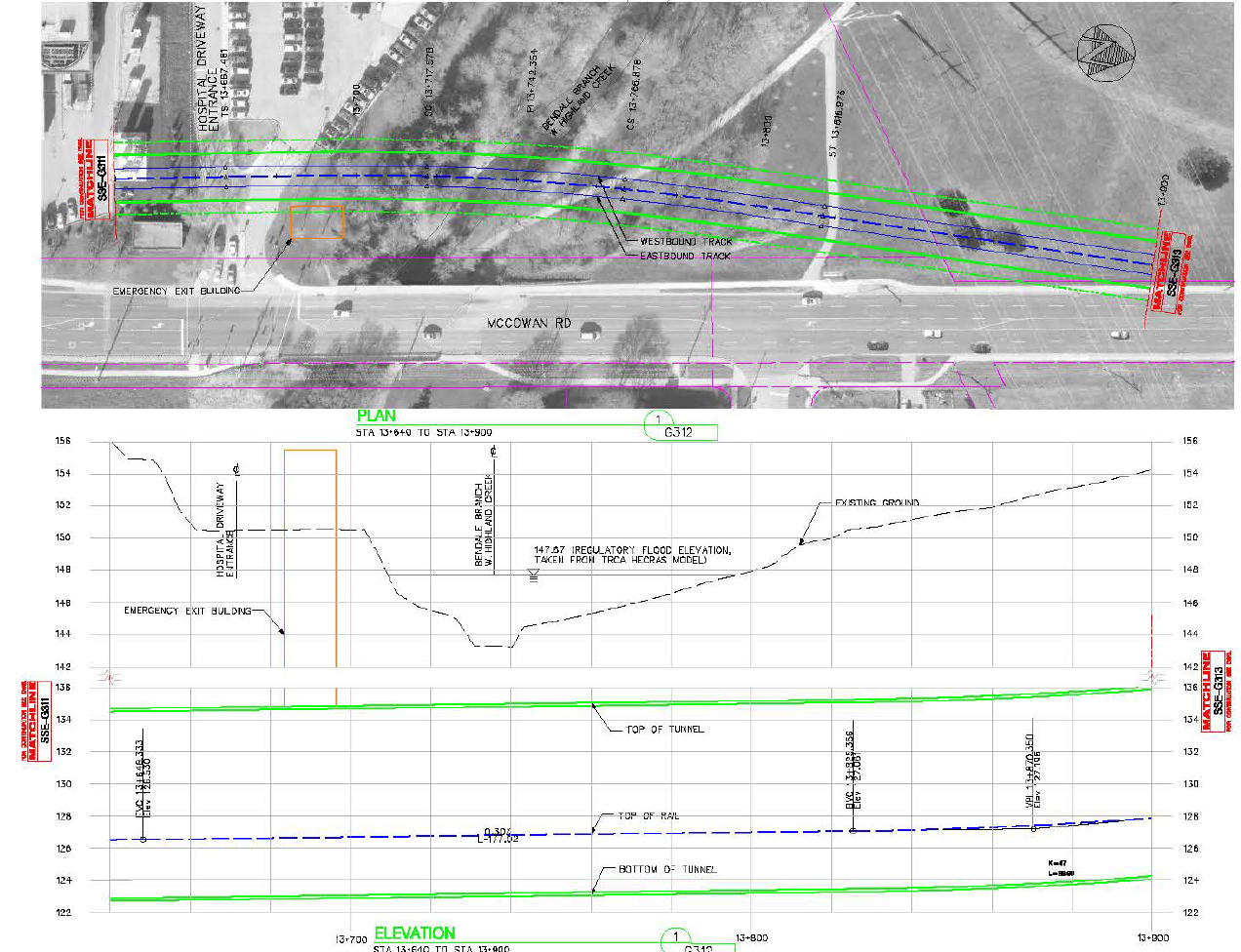

If you look at Drawing SSE-G312 on page 103 of Volume 1 of the 2017 TPAP it says the regulatory flood level is 147.87 m AMSL. So if the bottom of your structure, at best at 148 m AMSL (or higher!).
Meanwhile the north edge of Lawrence East at McCowan is about 157 metres dropping. So you've only got 9 metres to play with, assuming you super-elevate a bit north of Lawrence (using the planned river) crossing location just west of McCowan.
It would be tight - but it might be doable - depending how much safety factor you want on the flood stage. They probably they should revisit if they add a station. Will it save money though?

I'd suspect a bridge would be - soffit to top - no more than 6m - likely 5.5m. 0.5m bottom slab (spanning transversely), 4.5m internal box dimension, and 0.250mm top slab. Add another 0.250 mm for crossfall.
It's maybe the elevation at the north (Benleigh Drive) that's more critical. The entrance to the hospital just south of the bridge would have to be reconfigured.
The elevation there is pretty low - but that's okay, as the current plan has the entire tunnel west of McCowan at this point - so presumably the bridge could be entirely west of McCowan, and a higher elevation than McCowan.
The entrance is indeed an issue. They'd have to change that entrance completely .... perhaps move it further south where the elevation is higher. But that's probably a lesser issue.
Is there a link to these drawings?
