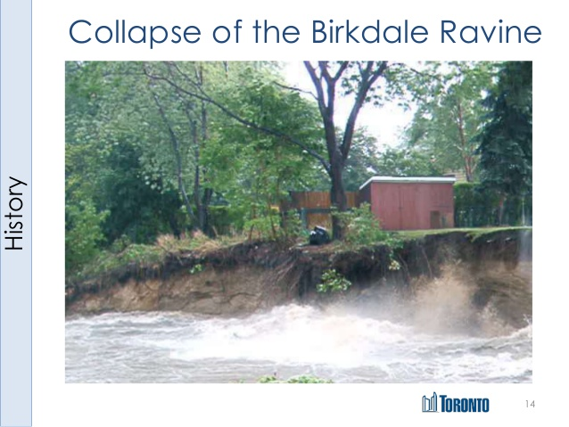

This image from a City of Toronto presentation is of the Birkdale Ravine, after the August 2005 storm.
Its just upstream from the McCowan bridge over the Bendale Branch of Highland Creek.
I'd suspect doubling the span of the bridge would help.
There is insufficient 'wiggle room' for a subway near the height of the existing bridge.
