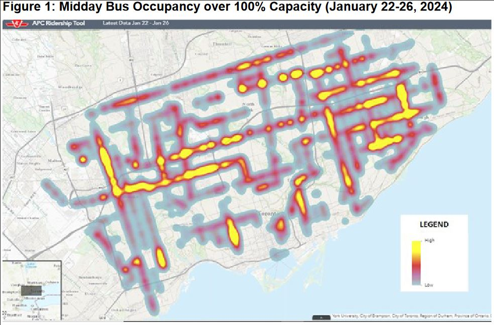

As to crowding, let's look at what the TTC's charts show:
This definitely shows the current buses in this areas a relatively full (look at all the yellow on Victoria Park as well.
Can't find one for the peak period just now.
Is that all? Not much yellow I think.
On Eglinton, its mostly near Kennedy Stn.
