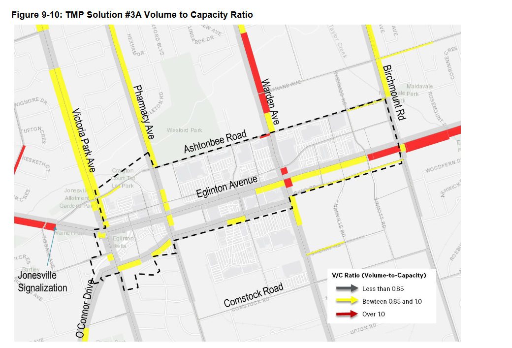

No, not if I say so; if all the traffic impact studies submitted with the associated development along the Golden Mile say so, which they do, and those have been published here, along with the Golden Mile Transportation Masterplan.
Red is over capacity, in the preferred build-out scenario:
(two variations)
Source: https://www.toronto.ca/wp-content/uploads/2019/11/97a2-CityPlanning_GoldenMile_TMPDraft_Part3.pdf
Further, from the above:
* before you say...... but we can have shorter headways.............. Nope, we can't, because the service has to interleave w/the short-turning service.
Ah, but you say, we can run ALL the service out to Kennedy. Nope, can't do that either as this would reduce the headway in the central section of the line.
Same thing I have had to say to a lot of posters today. I don't guess much. Its not a hunch, its not an intuition. I do my homework. If I'm guessing, I'll say so.
Line 5 is radically under-sized vs the development already proposed/approved along the east end of the route; we've going to have to go back and bury it.

There are alternatives, but as I've said elsewhere, they are all trade-offs.
You can just cap density in the Golden Mile and/or apply the 'H' or holding by-law to any development requiring they demonstrate sufficient transit capacity to support their development.
We could, bolster transit-priority, vs what is currently being contemplated, but with the admonition, that the N-S routes also show as over-capacity and these would be in conflict.
A further option would be more limited scope intervention, as example, grade-separating just 2 stops along the route that would create the greatest benefit, for argument's sake, Victoria Park and Warden.
The challenge there, is that the line would have to be completely shut down to construct this for a minimum of 2 years, and the resulting ramps eat up some of the time savings and may result in real challenges in say, serving a Pharmacy Avenue stop.
A final option would be eliminating a couple of the mid-block stops that would not be stations in an underground version of the line. (examples Lebovic and Ionview). The problem w/that, is that the time savings are limited unless you close the intersections or provide full transit priority; that the approved development pattern is predicated on those stops existing, and that the remaining stops have insufficient platform capacity to absorb the overflow.

@Undead is awesome, but his figures were guesses in terms of demand and do not align w/the projections and modelling we're seeing take shape.
There are lots of reasons his modelling isn't correct. For one it fails to account for existing corridor demand on the Eglinton Bus as base load, we're not starting from zero. All the Golden Mile development has to be added on top of that.
Second, there is an anticipated increase in transfers at Eglinton vs today from those who on the N-S routes, both in using the line to get to Line 1, the Ontario Line and to Kennedy.
Third, there is demand growth occurring in the corridors that feed the N-S routes or are otherwise just beyond the reach of the Golden Mile Plan.
