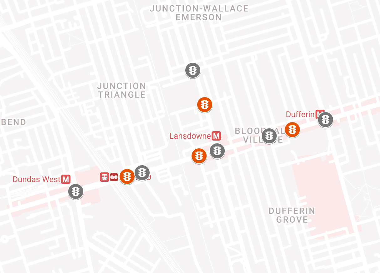

I know we have some traffic signal skeptics in this thread so I was curious to hear everyone's take on the city's plans in my neighbourhood.
I put together this map showing the existing (grey) and approved (red) traffic signals in my neighbourhood.
  • Bloor and Perth, approved based on a request from the former councillor
  • Bloor and St Helens, approved as part of the section 37 agreement for 1319 Bloor
  • Bloor and Pauline, approved as part of the Bloor and Dufferin redevelopment, replacing an existing PXO
  • Lansdowne and Paton, apparently required as part of the site plan approval for 640 Lansdowne (see "Traffic Operations Assessment"), replacing an existing PXO
This seems like a lot of new traffic lights. Too many? What could we be doing here instead of adding traffic lights at every other intersection?

My instinct is that is too many lights. I'd go so far as to say, my strong instinct.
But I"d still want to look for certain evidence.
1) What are the KSIs (Killed and Seriously injured) at the locations where lights are proposed. Are they inordinate to City norms?
2) Did the installation meet traffic warrants (were they recommended by City staff)
3) What is the distance between the new light and the nearest existing light?
4) What was the gap between the two nearest lights previously?
If:
The KSI in the area were lower than the City average; and the installation did not meet warrants, I could consider that affirmation that a new set of lights was not appropriate in that instance, barring extraordinary evidence.
If the the KSI were at or above City averages, that would indicate a need for intervention of some type, whether or not lights were the correct choice.
If the intersection met 'warrants' for lights......I'd be inclined to let it go w/some reluctance.
There are many potential alternatives to traffic lights, it really depends on what the perceived issue justifying the lights is........:
Is it existing danger to cyclists? to pedestrians? to drivers (car on car collision)?
Is it simply the wait to make a turn into/out of a given buiding or on/off a certain side street?
These bits of info are important, because they change how you might respond.
Its simply not possible for me to generalize.
That's a big blob of proposed stuff for someone more qualified than I, like @reaperexpress to look at..........but ya never know, he might humour you, LOL
For my part, I'll simply say, choices range from prohibiting and physically restricting certain turn movements, to protected intersections (space permitting) to greater physical separation of cycle tracks, to elevated crosswalks, to bumpouts/pinch points, to narrower traffic lanes to reducing/eliminating parking (for some combination, as appropriate, of wider sidewalk/streetscape, wider/more buffered cycle track, greater sightlines at intersections etc).
If gaps in traffic allowing turns is the goal, simply adjusting nearby signal times may be sufficient.
Suffice to say, traffic lights are unquestionably over-used in Toronto in general, but one requires a fair bit of info to pick apart individual choices.

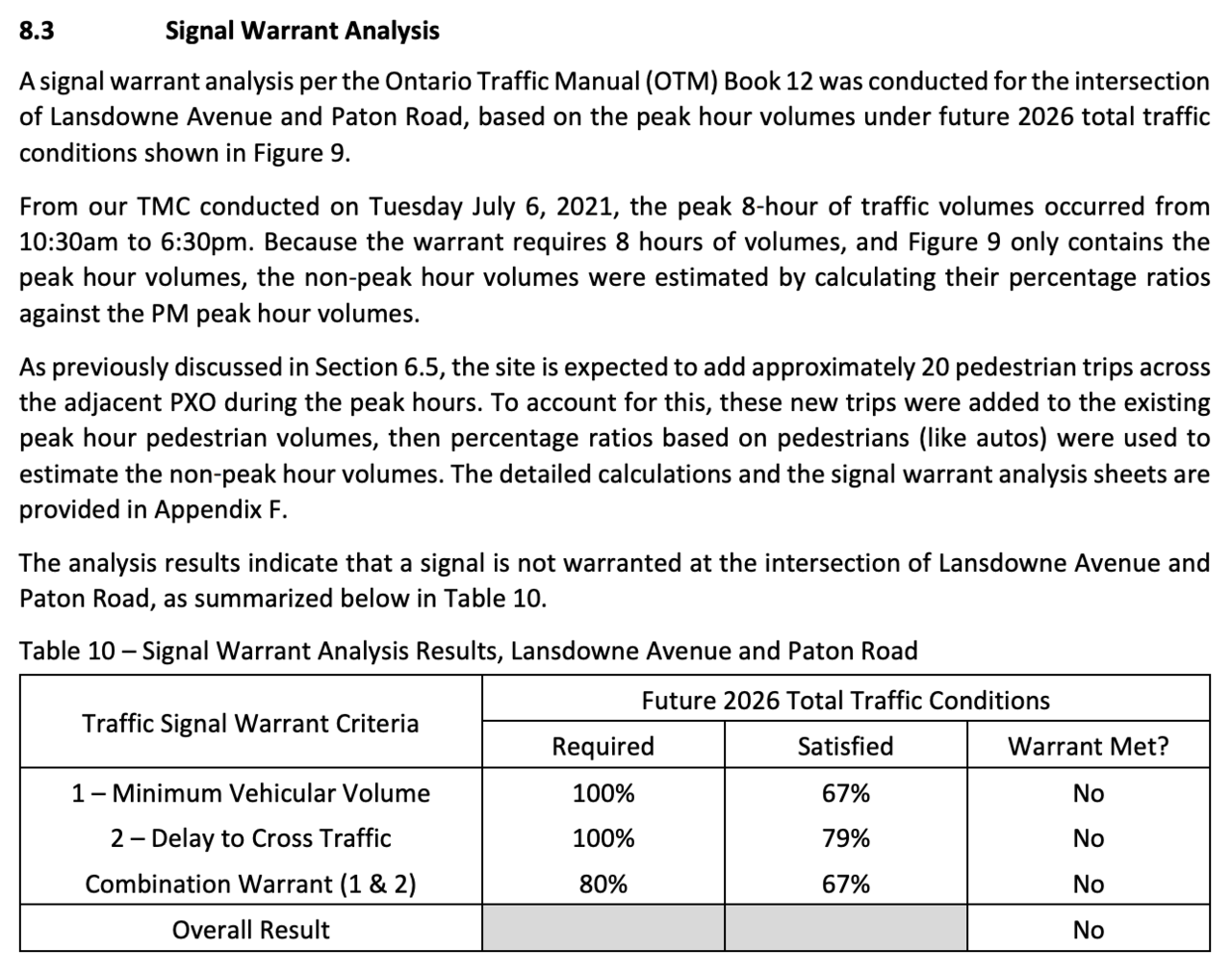

I wasn't able to dig up the documentation for Bloor/Perth or Bloor/St Helens. But for Lansdowne/Paton and Bloor/Pauline, neither met the warrant criteria but both were recommended by staff regardless.
Lansdowne and Paton warrant analysis:

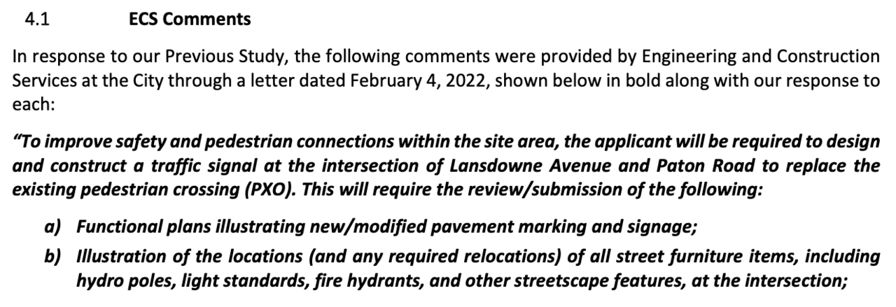

Staff response:

I'm inclined to think that the Bloor/Pauline signal is justified based on the reasoning in the staff report, but I would have liked to see a bit more analysis for Lansdowne/Paton.
I have no horse in this race, mostly just thought it was curious how many signals were proposed in a fairly small area and was hoping to learn from people with more knowledge on the subject.
