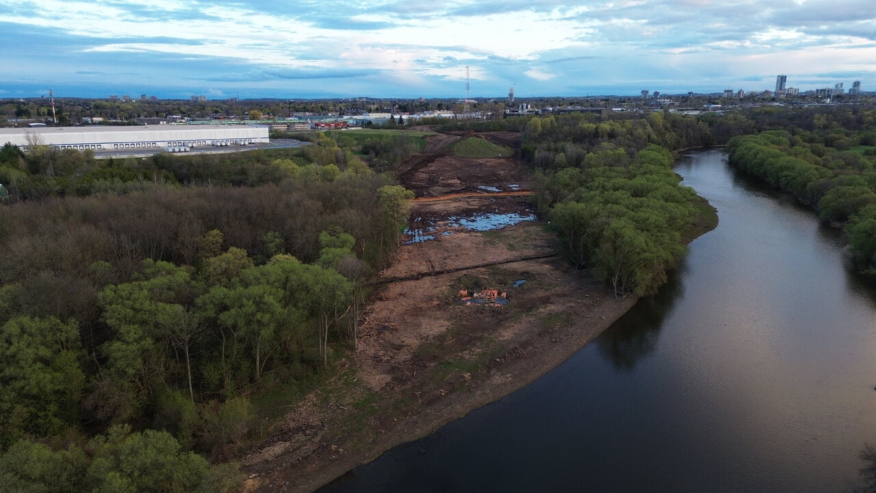

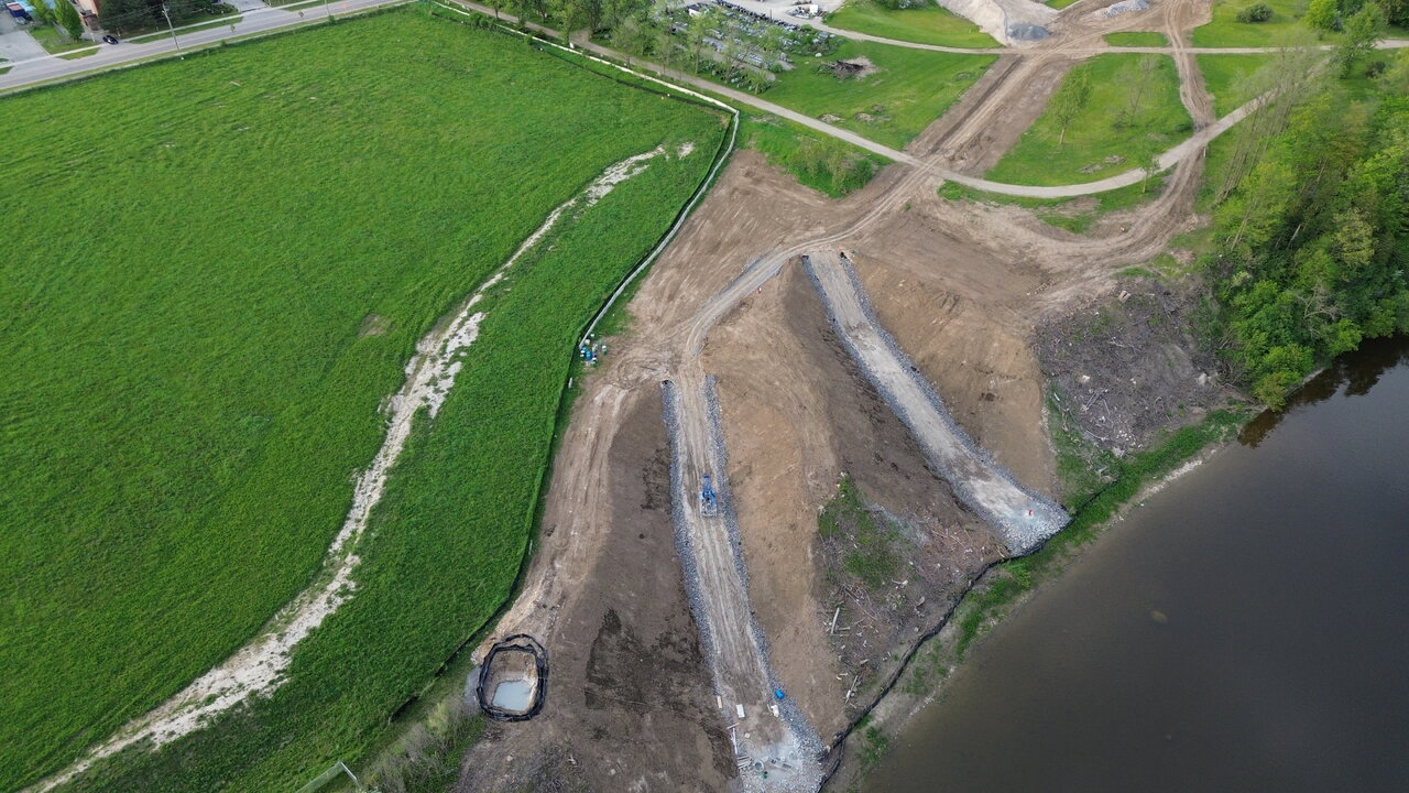

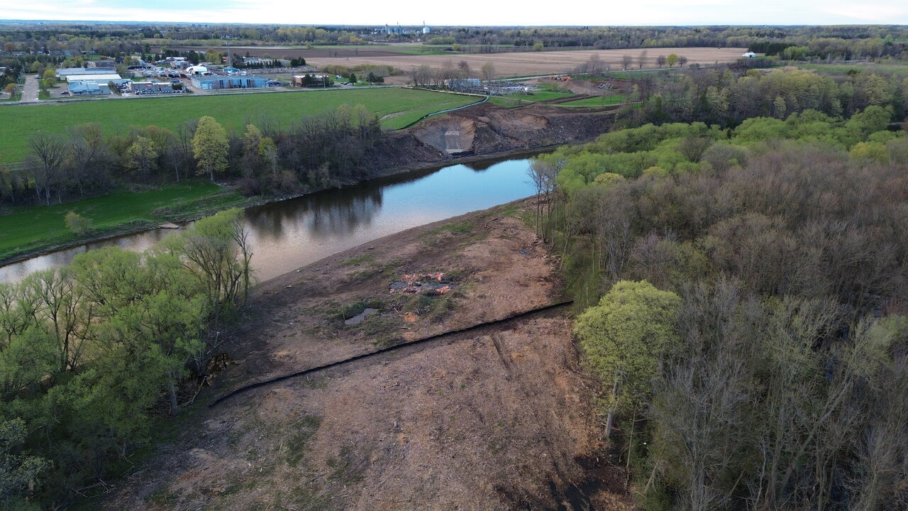

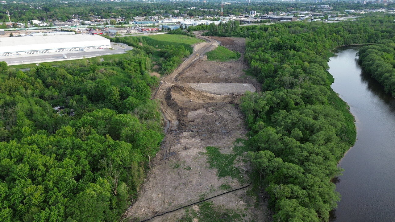

Work is progressing on the Kitchener end of New Highway 7, the location of the Grand River Bridges have been cleared with site grading works underway, the last bit of geotech work has commenced, they couldn't get a drill rig to the pier locations because of how forested/steep the terrain was so now that they've cleared everything and graded a bit they could get a rig down there.
April 29, 2026
May 26, 2026

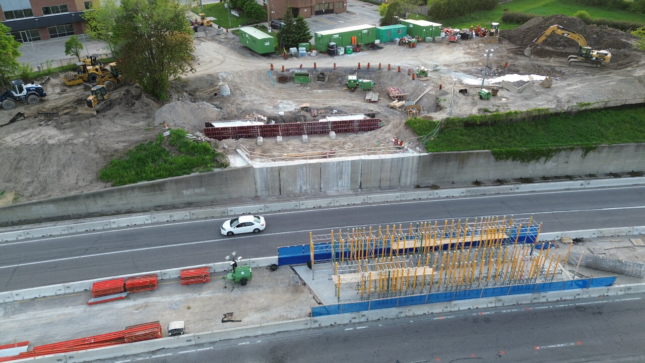

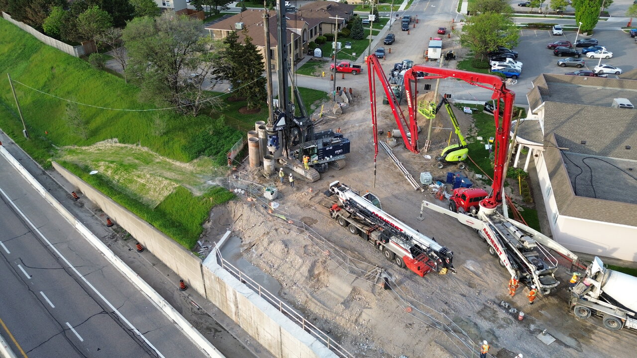

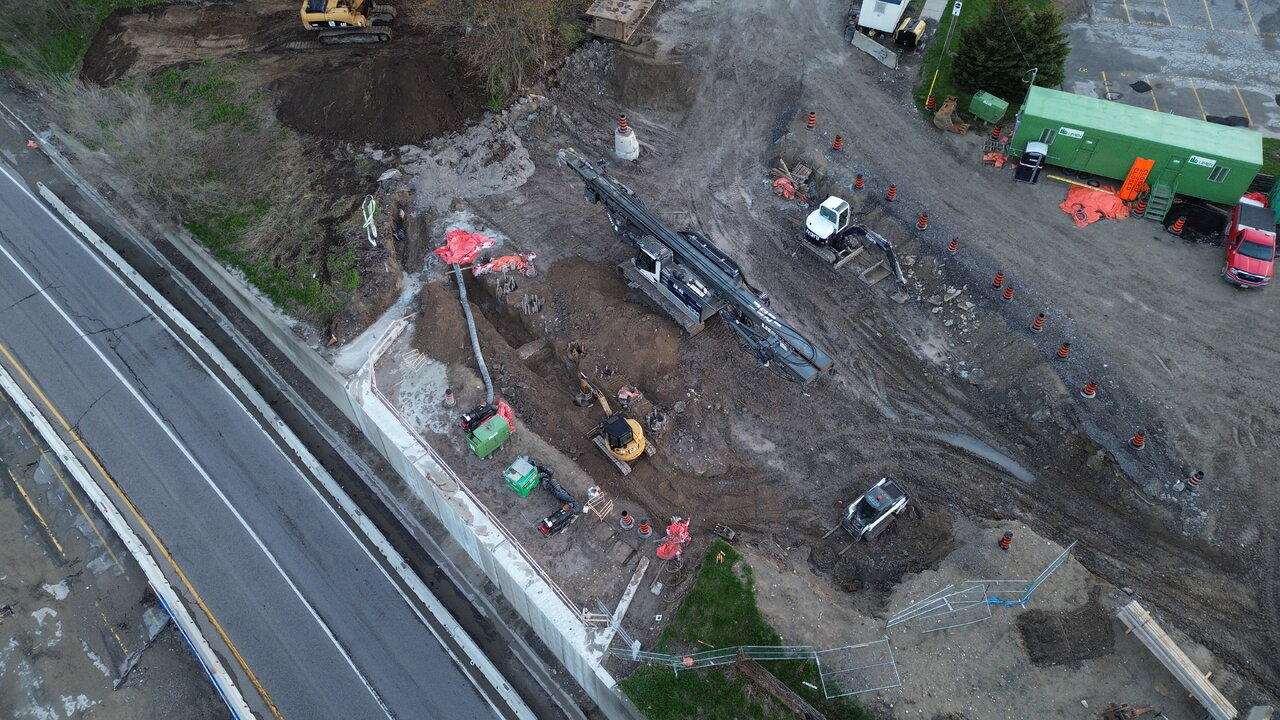

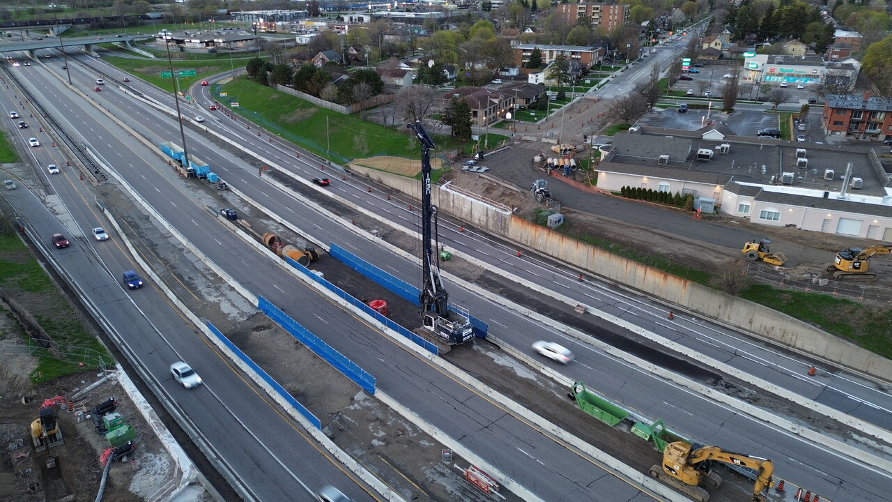

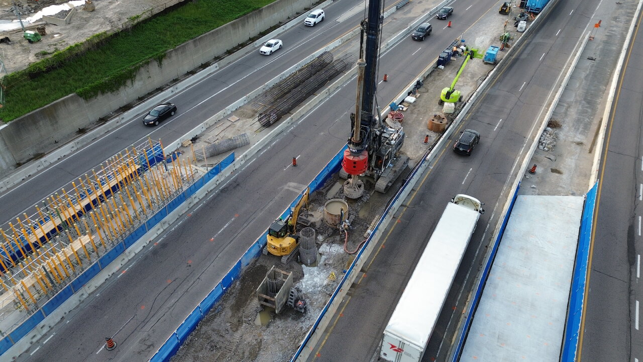

Work has also progressed on the Frederick Street bridge replacement, the abutment caissons on the Edna Street side are completed, and the Bruce Street ones are actively being drilled. Each abutment caisson is 0.8m in diameter and 35 meters deep. The central pier caissons are also almost completed, with the last one being drilled earlier this week, these caissons are each 2.1m in diameter and 30 meters deep.
April 29, 2026
May 26, 2026
