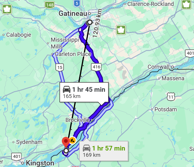

As the crow flies, Ottawa is 121 km from 1000 Island Bridge.
As the car drives, it's 165 km. That's not that bad - 75% efficiency. Knowing that the best-case scenario 100% is not possible.

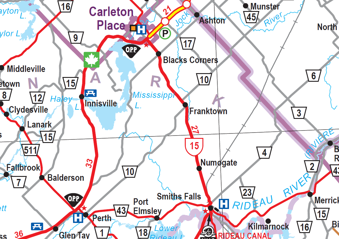

Before we got that far (and we certainly aren't there yet), would be something along the highway 15 corridor from Kingston (401) to Franktown - only 85 km.
(which leads to my thoughts about the next western of Highway 7 from Carleton Place. At that point Highway 7 and 15 split, with Highway 15 going south, and Highway 7 going west, up and around the quite large Mississippi Lake. Seems to me that it would make sense for a new 7 to turn and follow the 15 corridor for 8 to 10 km towards Frankton, and then new 7 splits off the 15 and heads west roughly along Lanark Road 10 to Perth staying SOUTH Mississippi Lake. Probably shorter, easier to construct, and less inteference with those living along the existing road alignment.)
I quickly measure this as 145km from the 1000 Island bridge to Ottawa - so it saves 20km. (maybe 30km it saves on the Kingston to Ottawa trip.

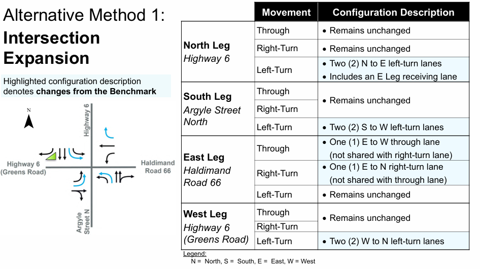

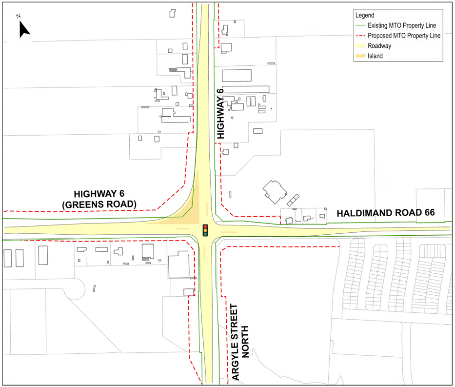

MTO is out for consultation on improvements to the Highway 6/Greens Road intersection in Caledonia. This is mostly the result of development in Caledonia which is leading to increased traffic in the intersection.
Interestingly MTO does not appear interested in pursuing the extension of the Highway 6 freeway to Caledonia and will be upgrading the intersection instead.
The preferred solution has been identified as:
Basically adding double-left turn lanes, a dedicated right turn lane on Haldimand Road 66, and expanding the curvature of the Highway 6 ramp connecting to the Caledonia Bypass.
