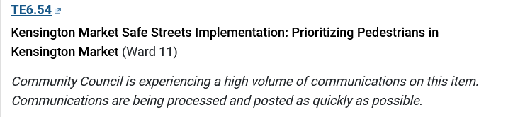

The report on the re-do and pedestrian prioritization of Kensington is headed to the next meeting of TEYCC.
It looks like it got slightly watered down to me.........with no pedestrian-exclusive zones being approved, pending a 'pilot'.
Disappointing. In some places, the whole area would be an obvious candidate for pedestrianization and blocked for through traffic. Even for the permit parking, there is a Green P lot there that could absorb some of the permit parking demand.

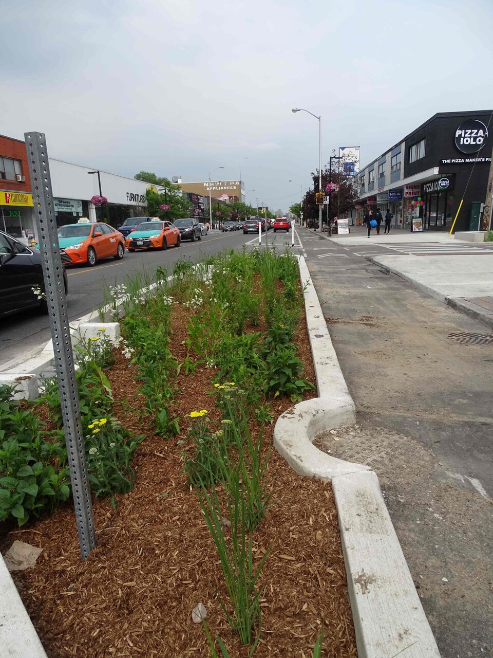

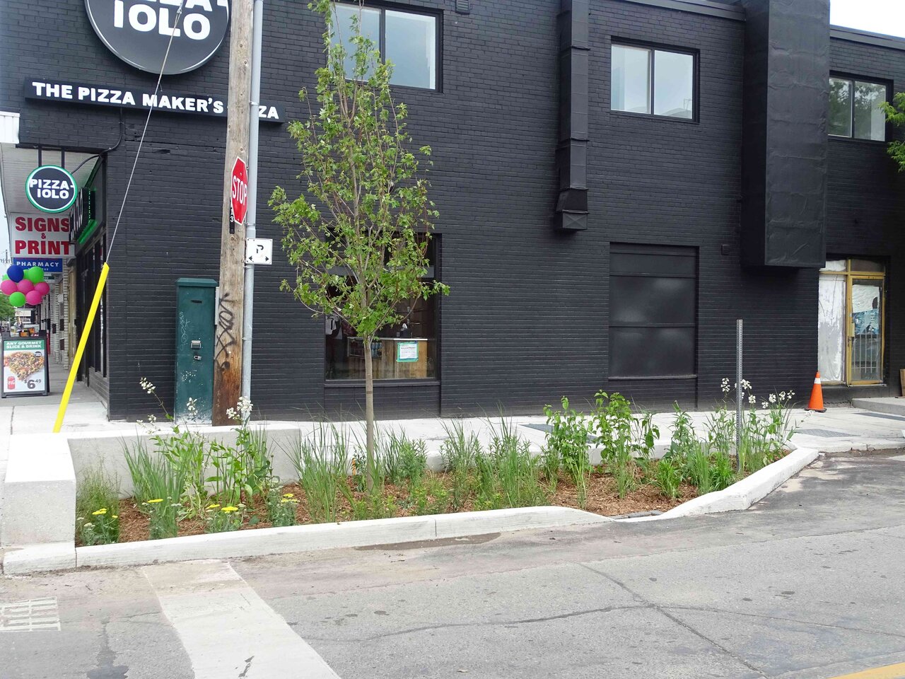

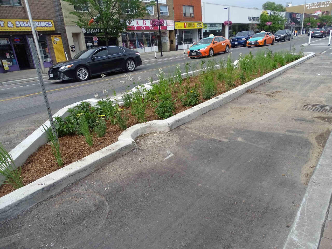

I popped by the Danforth/Kelvin site yesterday. Work is 95% finished. Plants are in. Only thing missing is the limestone coping on the seatwalls.
Photos taken June 15th, 2023:
Danforth side:
Cycle Track needs a bit of a sweep, but otherwise, looking really good here.
The plants aren't mature yet, but should do well.
There was supposed to be a tree in this island, unfortunately the as-built experience here was different from the plans, and a shallow gas line precluded that; but there are trees in the Kelvin planters.

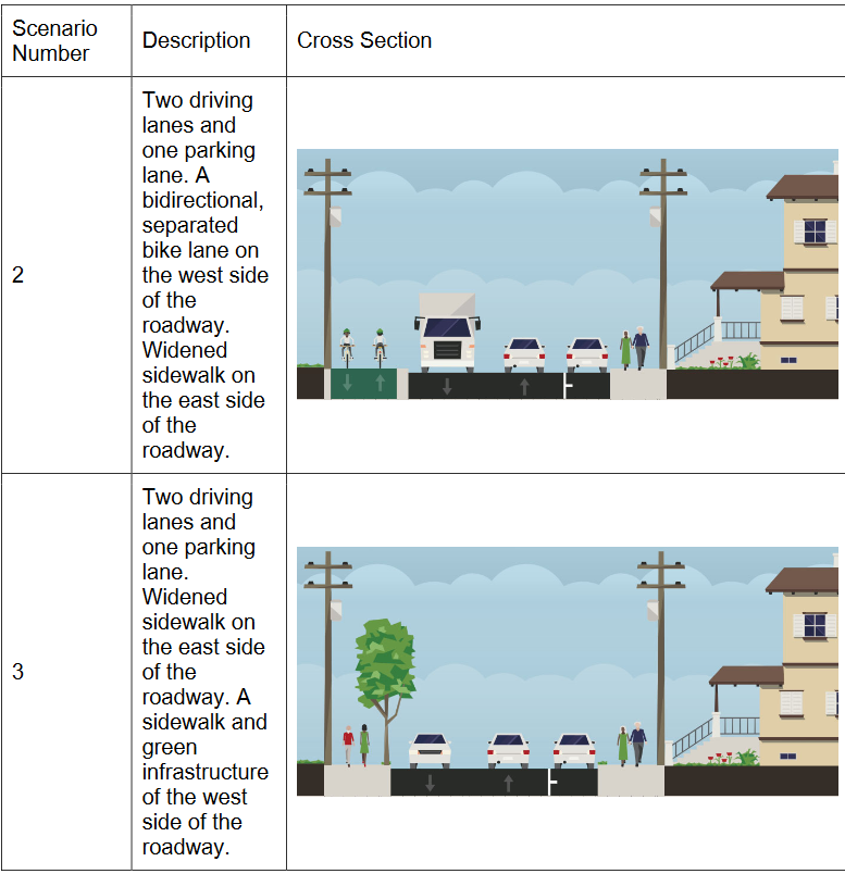

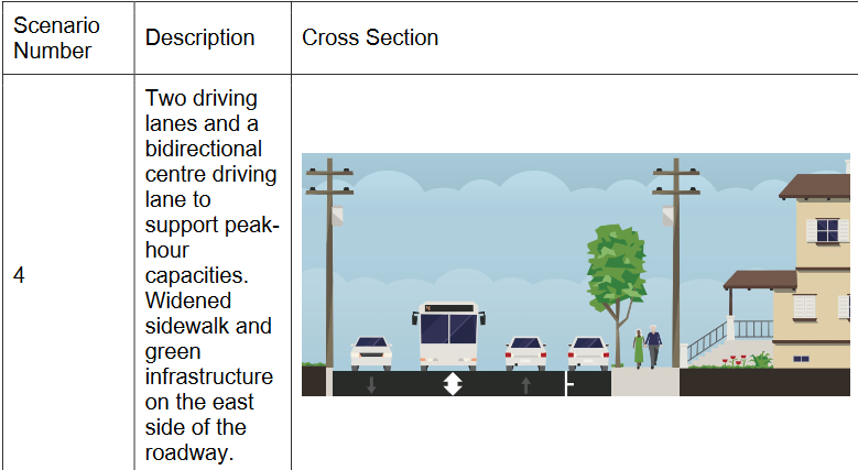

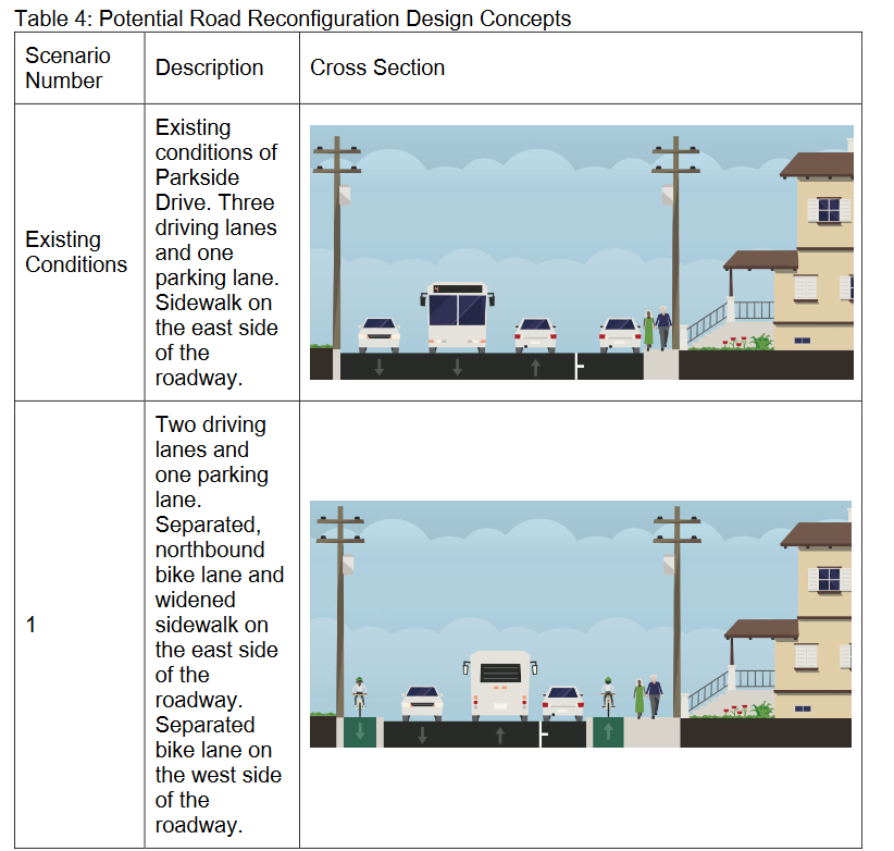

A report on the preliminary options for Parkside Drive is headed to next week's Infrastructure and Environment Ctte.
Upside: The recommendation is to pursue road reconfiguration/reconstruction which means removing at least one travel lane for cars, and aiming for a more complete street
Downside: Estimate for a timeline is latter half of the 2025-2035 Capital plan, so sometime from 2030 onwards.
One thing that is clearly wrong, however, is that when parking is included, all the proposals retain 3 lanes for cars in combination with cycle tracks/pedestrian/greening improvements in various combinations.
What this means is that, we can't have any green infra (new trees/boulevard planting) and have cycle tracks.
I vote no. At the very least an option with no parking should be considered, this would allow for cycle tracks/MUP AND greening/boulevard treatments.
Concepts:
My ask UT is that you write Councillor Perks and/or Councillor Saxe (she's on the Committee) and ask for a motion to include study of an option with no parking and how the demand for same could
be met by using pay and display on nearby streets. Such option to feature both cycle tracks and widened, green sidewalks. (one added boulevard and/or landscape buffer for an Multi-use path)
My preference is the MUP, or bidirectional cycle track here, as that would be consistent w/the design of Martin Goodman Trail to which it could be linked; it also allows for a landscaped buffer between the trail and the road, which could be done with native plants and aid in the ecological restoration of High Park in the process.
^I'm supportive of eliminating parking, but if that doesn't fly
Does the option(s) retaining parking include barriers/islands to discourage impatient drivers from jumping into empty parking space and/or at intersections in hopes of overtaking one or more vehicles ahead?
I see a lot of that on Parkside northbound. Using the curb lane as parking (sometimes) and a driving lane (at peak) doesn't work well here. I would be opposed to any proposal that retains parking but doesn't address that issue.
