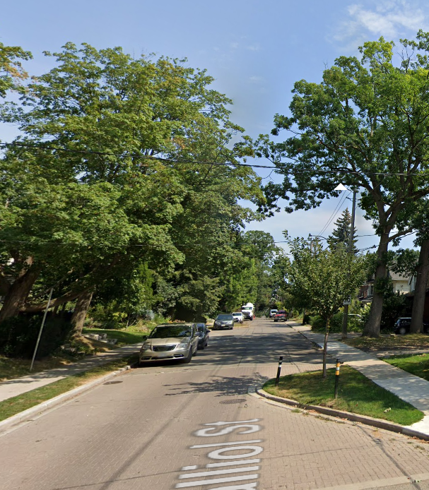

The pilot project for these was.... 1994! Had to look it up! , it was Balliol from Mt. Pleasant to Bayview.
Streetview from '21 shows the chicanes are still there:

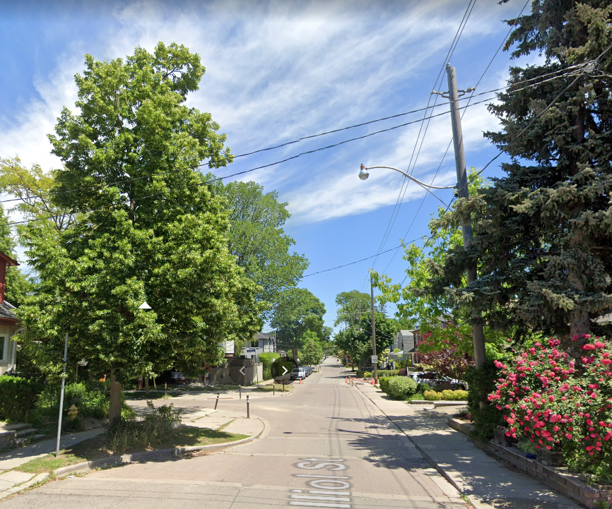

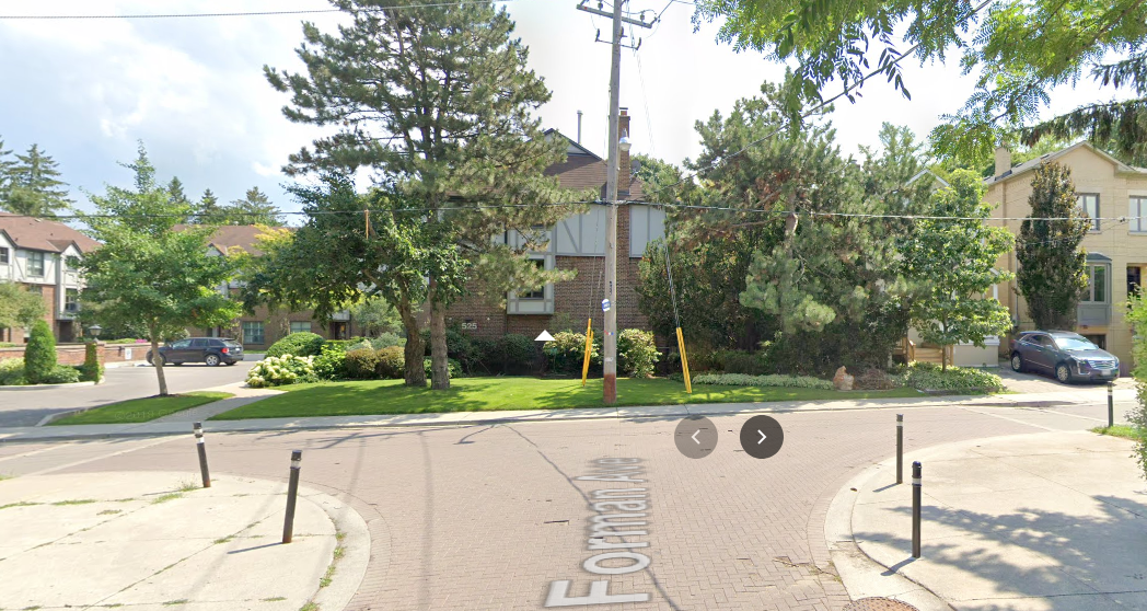

An intersection treatment:

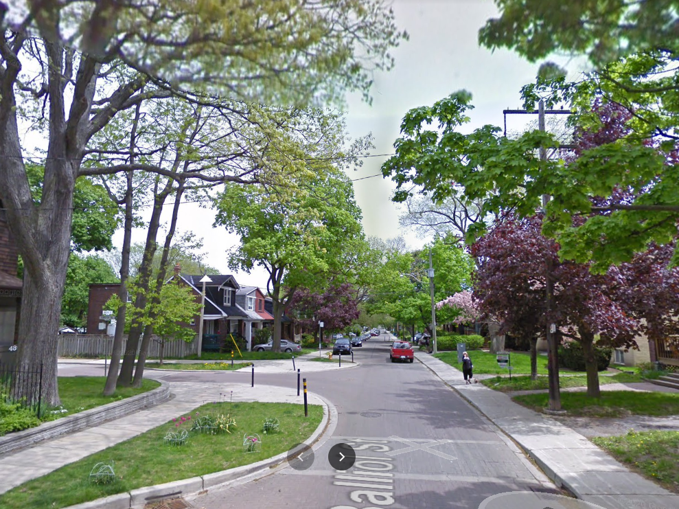

Different intersection, this time the approach to Balliol:

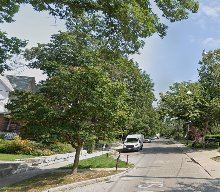

This one will be one of the original trees from the project:
Note the absence of stop signs at many, but not all treated intersections. That was intentional, to allow steady, but slow flow.

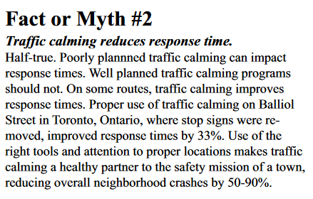

From this report:
We learn:
