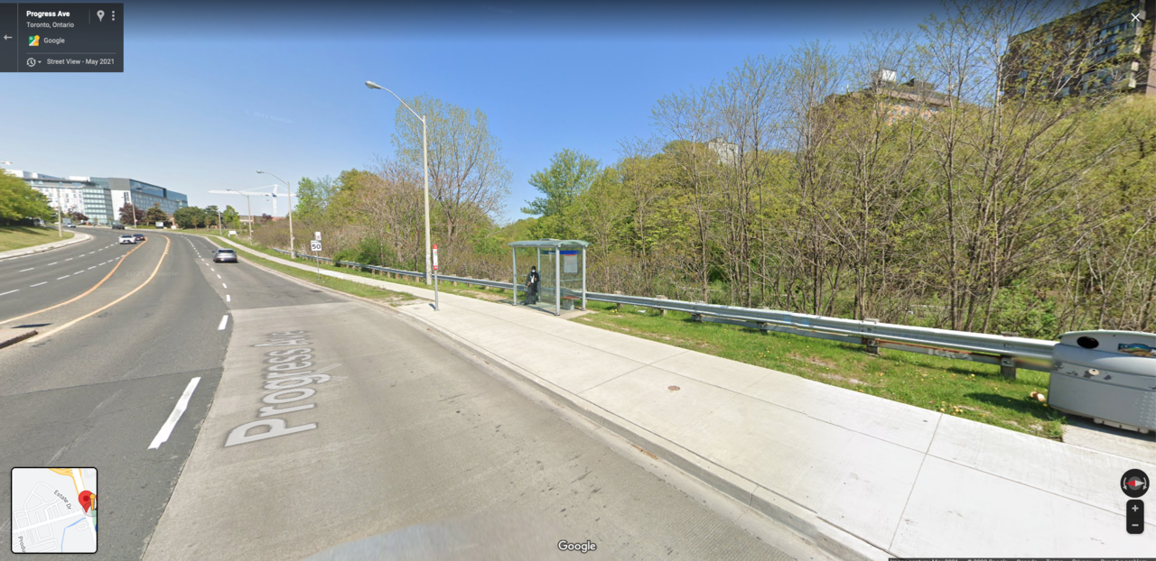

Remember Progress Avenue & Markham Road in Scarborough. Where two pedestrians were killed in December, 2019. See link.
This is an image from Google Maps Street View (dated May 2021). From link. No real improvements for pedestrians.
Note how the guardrail protects the trees and valley from pedestrians who may wonder off the sidewalk into the hill behind the guardrail.
No protection from motorists driving at the alleged 50 km/h posted speed limit (insert laugh track here). No protection for the people at the bus stop nor inside the bus shelter. The bus shelter and bust stop sign will "breakaway" to prevent serious damage to the occupants of the possible motor vehicle, since that is "very important". People are unimportant.
