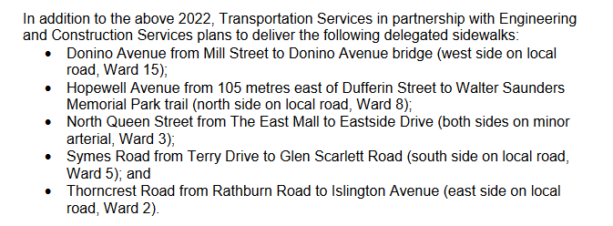

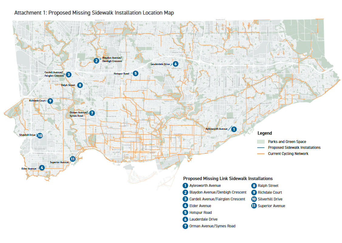

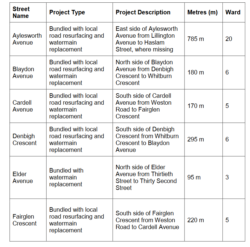

Report to next week's Infrastructure and Environment Ctte on this year's program for new sidewalks (filling in the gaps)
From the above:
