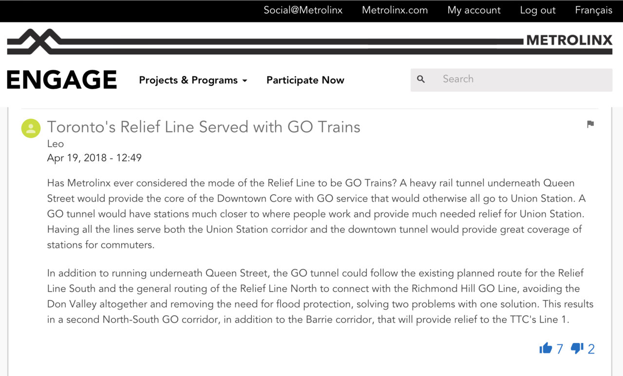

Speaking of interlining DRL and RH line....
It is one of the top 10 questions at the Metrolinx Town Hall this Monday, so it probably will have some kind of statement/comment to this regards:
That said, if it ever happens, it would be metro/subway trains, single deck level boarding, not the original big BiLevel trains.
