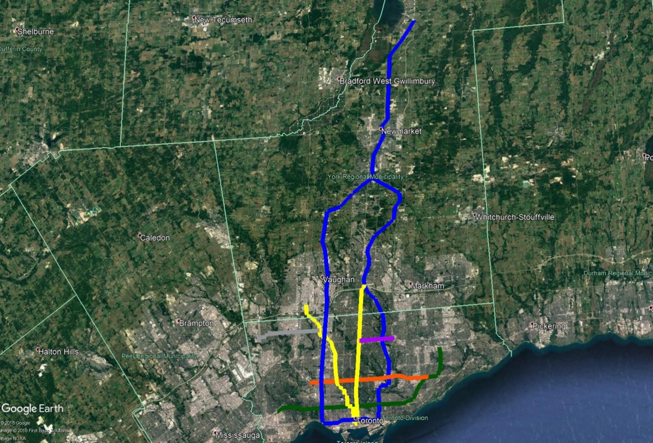

Something crazy like this?

Yes, pretty much, except the Barrie Line would continue north to Bradford and continue as usual to Barrie. That would be the trickiest part due to tunneling, land expropriation and crossing the Holland Marsh.

And the province ensures that the Northlander can never return to it's old rout ever. The RH line is the one that it used to follow in the GTA after tracks were removed between Washago and Barrie.
Doing this is akin to removing the elevated Gardiner sections. Sounds good on paper, and for the locals it is great. But from those beyond that section, it really can be a very bad thing.
Not quite what I meant by LRT, but, crazy concept!
