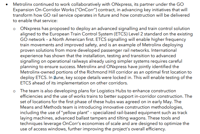

Does this mean MX is abandoning ETCS?
I bet they are. It never made sense to announce a new signaling system for GO trains without any consultation with the freight rail companies.

Does all of this mean ETCS won't be happening on the Richmond Hill line? Was excited to see some meaningful improvements to the Richmond Hill line.
I don't think I would necessarily hang the likelihood of such weighty changes on someone asking "ETCS over???" and someone replying "I bet! Having two signal systems make locos schizophrenic"
The use of the Metrolinx piece of the Richmond Hill line was probably linked to the new layover at York Mills and/or the frequency on the section being less tricky to deal with than elsewhere for test scenarios. Even if the specific choice of ETCS is abandoned for ACSES or something else, the expectations around the number of trains headed into/out of USRC over the next decade demand a better train protection system of some description (and arguably is multiple decades overdue already) even if some trains have to be routed through in a degraded mode.
Not the former, absolutely the latter.
This is why Richmond Hill is also the test bed for the GTCS - GO's own signal control system, independent from CN's RTC-II.

Because the job posting doesn't ask for ETCS experience as a requirement, simply that candidates must have extensive signalling experience, Metrolinx may have walked back on its adoption. The new in-house team may be charged with doing their own assessment of available options, and implementing one.
