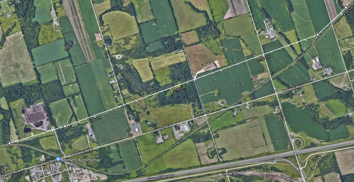

The CP Belleville at that point is a single track line with some sidings. Some track expansion (and thus $) is required in any event. Increased activity on grade crossings is undesirable on several levels, particularly given the proximity of the CPR to Darlington Nuclear (although those particular roads may not be necessary for plant incident response)
Below is a rough outline of what I have in mind. I find the notion of "where will we find the cash for land" to construct 4km of two-track embanked railway and some bridges a bit hard to take given the vast swathes of land purchased for 418 (not shown in the imagery available) and the 407 (which can be seen further north in construction phase)

If I recall the bush between Rundle Rd and Solina is fairly wet. Costly plus the toll on a environmentally risky area.
(confirmed it is swampy per the MNR map...there is often reasons why the original route was chosen)
^ The irony is that there was once an 1800’s era Grand Trunk Railway right of way parallel to what you suggest - you can see its remnants at the bottom right of your screen shot. Some of the civil works from that line were removed not that long ago.
To my mind, the limiting factor in what you suggest is whatever design was developed for the 418. It’s probably too late to revisit a lot of that - a change order to 418 construction would waste a lot of money. Perhaps for that reason alone, maybe the CP ROW needs to prevail.
As to CP’s involvement in all this, CP was very involved in the original EA, and the EA’s end design reflects CP’s druthers as of that date. On the one hand, that predated the Harrison Precision Railroad era, but on the other hand CP does have an active dialog with ML - better than one might think - and I don’t believe ML would be foolish enogh to broadside CP completely. And on the other hand, since ML is as happy with offering an excuse for inaction as with delivering shovels in the ground, perhaps CP has told them to f—- off completely and the route redesign reflects that. So that’s a wordy way to say, we don’t know....but CP’s participation, or not, is likely not the defining factor in this. My gut says they will cooperate with the east end part but don’t want GO on their route thru Oshawa.... perhaps for real estate reasons.

Railway alignments were (are) usually laid out in consideration of curvature, grade and cost (as expressed in terms of the technology of the day). Seeing as the two ends of 'the dip' seem to end up at roughly the same bearing, it would be interesting to know why they laid it out that way originally. Even if more feasible with today's methods, land acquisition costs would remain an issue unless there is some spare change in government funding that isn't needed elsewhere.
Keep in mind, too, that this particular segment of railway is not some 1850s, hack-and-slash, get-it-built-now-and-on-the-cheap alignment. The Belleville Sub was surveyed and built between 1904-ish and 1914. And with the huge improvements in the speed, size and quality of railway equipment and technology in the 50-ish years that the railways had been running in the area, it was built to a far, far, far higher standard than the older in-land route via Peterborough. In the 1850s, they would avoid any geological trouble spots because they were in a hurry. By the 1900s, if they avoided that kind of spot it wasn't because time was of the essence - it was because it was just too difficult for them to accomplish.
All this is not to say that they couldn't do it today - the technology has come even further. But it does put a bit of perspective on the whole thing and why they may have made the choices that they did.

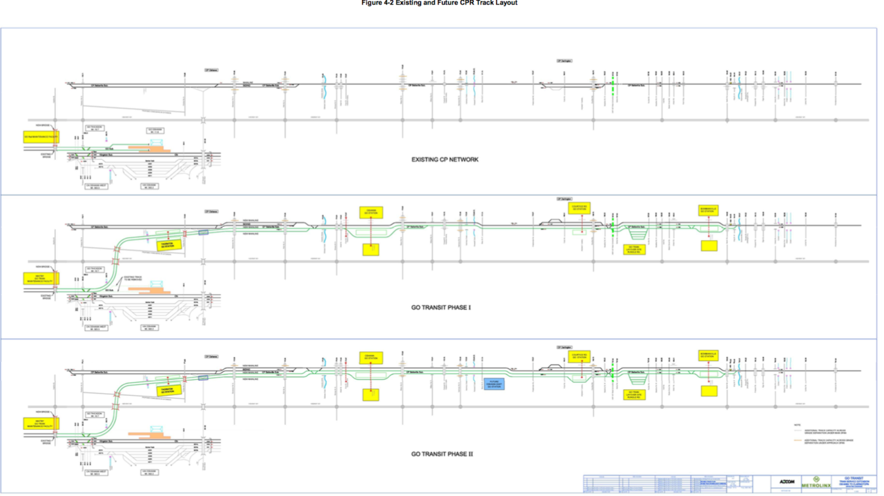

^ In the original EA, (The original EA report has disappeared from the ML website, but I have a copy..... Some documentation can be found in municipal archives eg here.) the new track was planned in places to the north of the existing track. I believe curvature and clearances on the right of way made it more desirable to build the new trackage on the north side. In effect GO, would have taken CP's existing track and CP would have the new (north) track. The plan would have required building a third track where CP had an existing siding, which implies they intended to operate as a separated flow, crossovers and double track notwithstanding. The layout of station platforms does suggest that GO would normally have access to only one track, but crossovers were planned that would allow CP and GO to use either track when necessary.
Going forward, it's up to CP whether they want GO to have its own tracks (like the GO sub east of Pickering) or to share tracks with freight (as on the Milton line).
