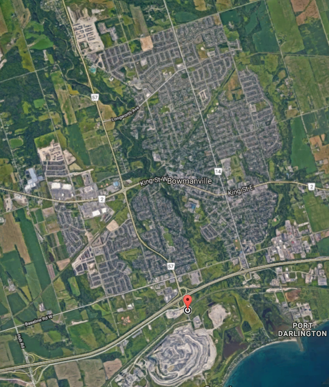

Lakeshore East Rail Corridor – Bowmanville Extension Update Meetings (Reminder)
Metrolinx to Significantly Increase Trains to Bowmanville
One of our goals is to find a way to get more rail service to communities beyond Oshawa as quickly as we can, and to do so with an all-day service. The original plan from a few years ago was for limited service in the morning and evening peaks only. Theoptions we are now considering are based on operating train service throughout the day. You are invited to attend one of our community meetings to learn more about thefour options we are considering to extend GO service beyond Oshawa. You can review the options here.
You can tell Metrolinx is angling for Option 3 4. While I don't hate it as it retains existing infrastructure at Oshawa GO and will most likely result in significantly higher speeds for the trip to Bowmanville, Missing the planned Ritson station is pretty poor land use planning. That station would be a boon for access to Downtown Oshawa, which actually has quite a few active development applications right now and seems to be really turning a corner in a lot of ways.
I think it's easy to forget that half the purpose of the Bowmanville Extension was to improve service to Oshawa, and Option 3 4 removes a lot of those benefits.
Regardless, It's exciting to see that they are now planning for all day service. I always found that to be a pretty major issue with the old plan.
The fine print still doesn't make sense according to what's being touted:
Electrified GO Expansion services will terminate at Oshawa station.
- Option 3
Go figure...(Best I detail as it will be missed by some: System-wide planned RER electrified is the prerequisite for "15 min all-day two way" since present stock numbers are woefully inadequate to do so) In the event, I take anything coming out of the Metrolinx Fantasy Fiesta with a grain of magic dust. It's going to be three and half years until anything believable or concrete happens from ML. And then the following regime will have the legitimate excuse: "The Ford Tories left the cupboard looted and bare. It will take years to rebuild the plans to expand".
Btw: I notice that the 'Get Out of Promise Free' card has been expunged from a number of ML docs. The (gist) "contingent on the Immaculate Leader's whims' clause.
I'll reference later, must run.
You can tell Metrolinx is angling for Option 3. While I don't hate it as it retains existing infrastructure at Oshawa GO and will most likely result in significantly higher speeds for the trip to Bowmanville, Missing the planned Ritson station is pretty poor land use planning. That station would be a boon for access to Downtown Oshawa, which actually has quite a few active development applications right now and seems to be really turning a corner in a lot of ways.
I think it's easy to forget that half the purpose of the Bowmanville Extension was to improve service to Oshawa, and Option 3 removes a lot of those benefits.
And similarly, look at where the station in Bowmanville will be relocated to under Option 3. Man, Durham region just continues to be an epic failure in land use planning.
