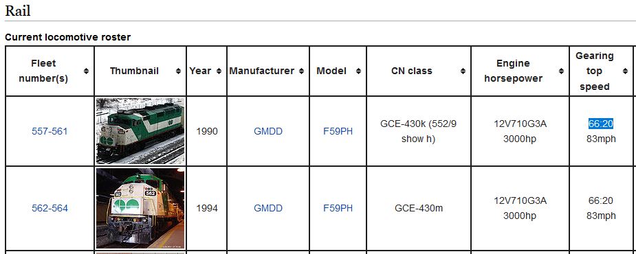

GO's F59's have a top speed of 83 mph (133 km/h). I'm not sure what the speed limit is for the coaches, but they do operate up to 93 mph (150 km/h) in regular service.

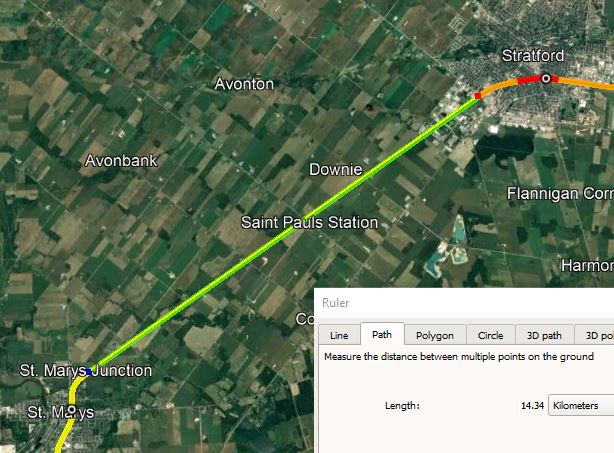

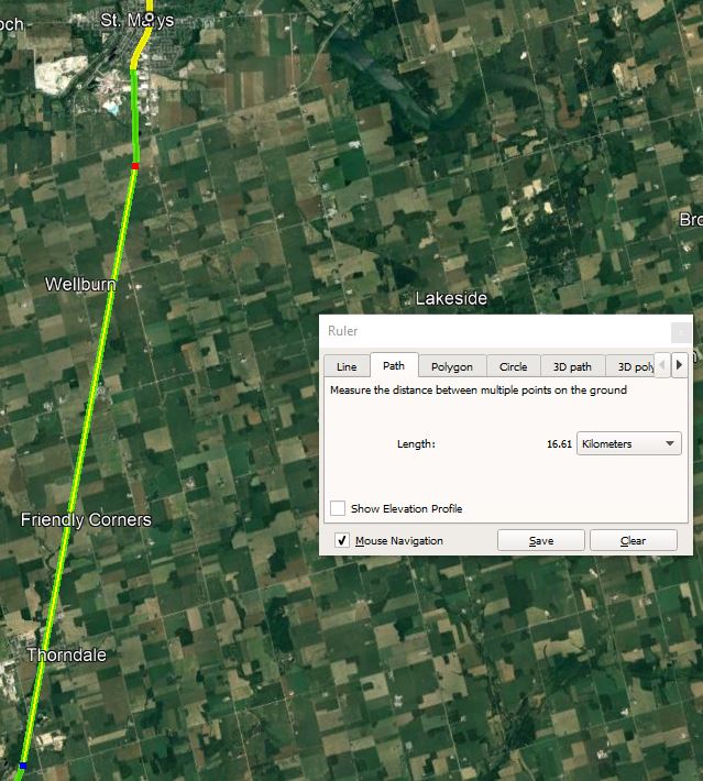

110 mph on the London line would be nice, but it's worth noting that you get rapidly diminishing returns as you increase the track speed above the speed the curves can handle. After a certain point the benefit becomes zero as the train can't even reach the track speed before it needs to slow for the next curve. Trains will always need to operate slowly (30 mph?) through St. Mary's and Stratford due to the sharp curves which cannot be widened. Just west of Kitchener there's a series of curves which limit speeds to around 80 mph or so. I'm sure trains could briefly reach 110 mph in spots between the curves, but I don't imagine they'd be able to sustain those speeds long enough to make a measureable difference compared to a 95 mph track speed.

I really have to disagree with this, there are large portions of that section of the GEXR thats super straight. Yes there are some curves but they pale in comparison to how many straight sections there are. This isn't a constantly wavering track through a valley or something.
As for the F59's I find that very surprising, i'd love to see some documentation on that. Most F59's have a 110mph top speed, and the ones own by GO were refurbished in 2011. I can't imagine they would be run down by now.
